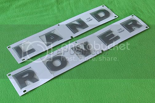

No I def don't want them black I was thinking sliver so do I need to buy any lettering or jus paint the black lettering to sliver or grey...
EIGHTLUG
Mar 2, 2011
194
I'd buy the new lettering. Tape off the lines and spacing of your old black letters with blue 3M painters tape. Maybe layer the tape so you don't scratch the hood when removing the letters with an emblem remover. (There are no alignment holes) Then remove the old letters one by one with a heat gun and a plastic emblem remover. Also pick up some 3M adhesive remover from your local auto parts store, to clean up the old adhesive's residue. Reapply the new letters. It'll be easier and look more factory than trying to tape off each individual letter and the hood and shoot them silver IMO.
jjvd21
Jul 7, 2007
577
36
Remove old letters using fishing line or similar. Remove residue. Measure according to picture below, tape cardboard onto hood using measurements, then place new "Land' and "Rover" against cardboard and onto hood. Perfect placement.
EIGHTLUG
Mar 2, 2011
194
Great pics JJVD! That's exactly what I was talking about.
