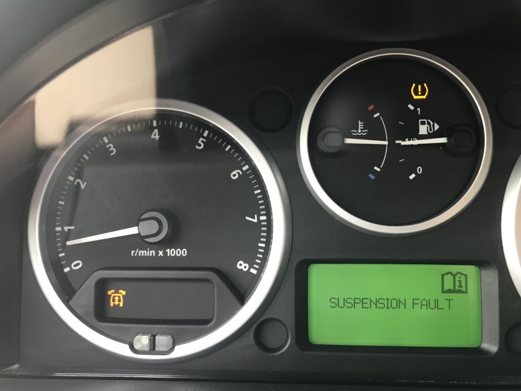

4. after some time engine running "suspension fault" indication will appear always! and rarely "suspension fault normal height only" indication.

Ok, With the jack trying to lift the front driver side was able to hear the leak louder when raising, then no leak sound, I turned the engine on a few times to make compressor charge air bag but no leak sound so I gave up. Then next morning going to work I turned on engine and right away suspensión fault warning showed up, and front suspension wasn't raising and no compressor noise... does the compressor just quit??

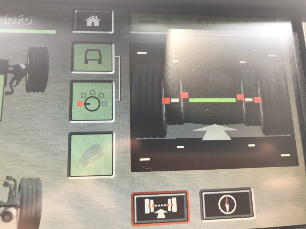

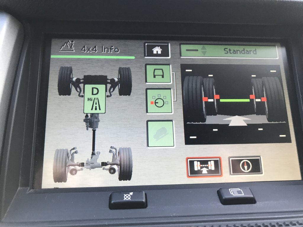

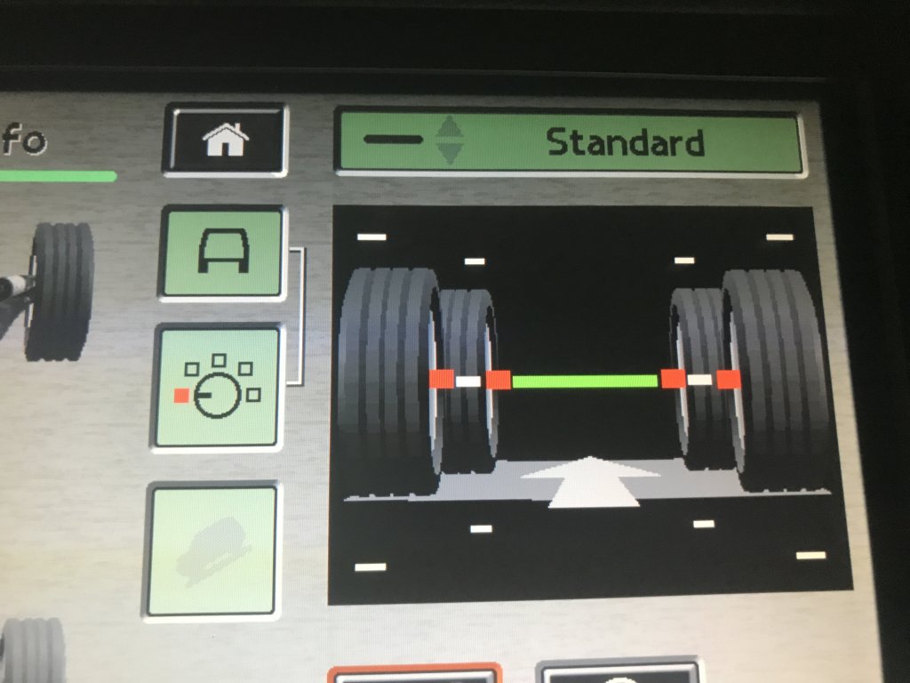

It is in standard height, back side is normal but the front side is totally down, I turned the engine on and off a couple times to reset the sistem even tried lifting and lowering it but nothing happened
Houm_WA
Jan 6, 2006
3,948
261
I'd try a hard reset, then report back here. If the compressor is completely unresponsive you may be in need of a new one. Sometimes you have to get it "close" to where it's expected before it will kick in but it looks like (based on your 4x4 Info screen) that isn't a problem. I'm thinking that your compressor has gone ****. Bad deal.
