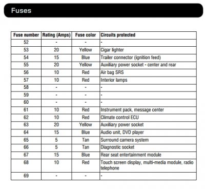

The front 12V Auxiliary Power Outlet (not the cigar lighter) in my 2011 LR4 HSE is not working. Thinking it was probably a blown fuse, I set about changing it. Still no luck. I get power to the cigar lighter, rear seat power outlet, and the outlet in the rear cargo space. I know the outlets only have power when the ignition is on.
So I checked 20 Amp fuses 53, 55, and 63 by pulling the fuse and testing it with a continuity tester. I even replaced fuse 55 with a brand new fuse, no luck. I'm pretty sure that fuse 55 is used for both the front console outlet and the rear seat outlet. I pulled fuse 55 and the rear outlet stopped working.
Any clues as to what may be the problem?

what Umbertob said. can you remove the socket and check the 12v wires behind it?
