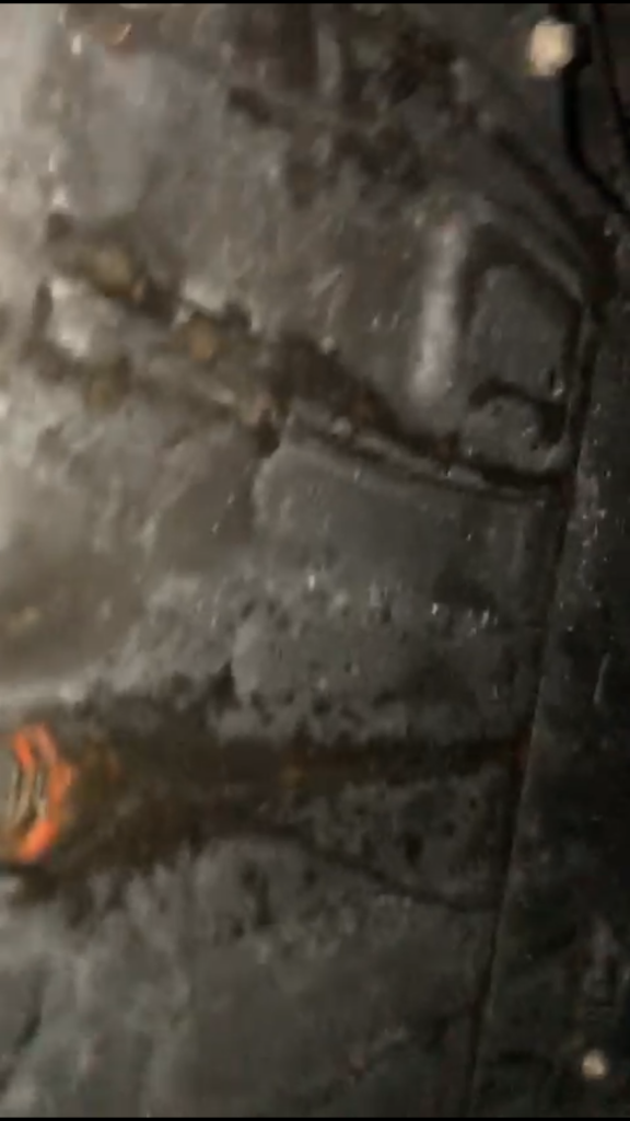

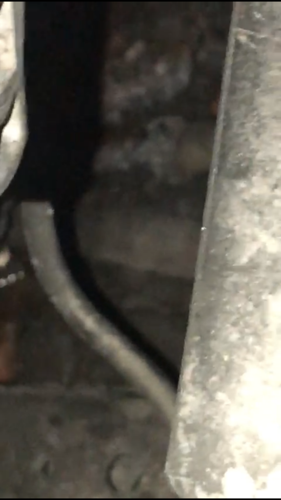

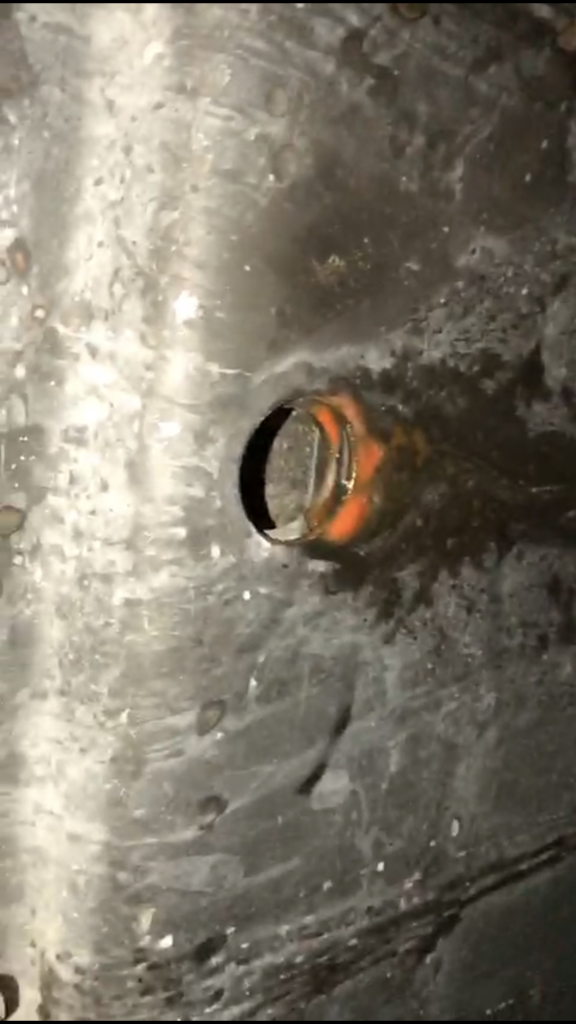

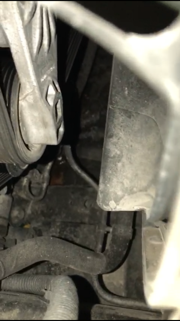

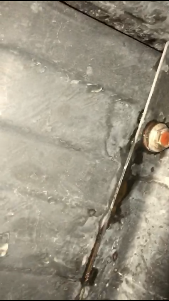

All went good that day... however when I reached back home & 6 days later I got the warring again! Low coolant! I am not sure what can it be? Looking under the car I see marks of coolant and same smell again... coolant tank is empty now!

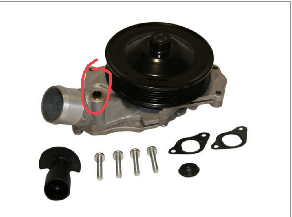

That definitely looks like it’s leaking from the front. I’d suspect water pump return connection or something your shop reconnected. There’s a little pressure fitting on the front of the water pump that sometimes won’t seat correctly. I’d start there.

On the 4 there’s definitely a redesigned return (which I could not get to seat into the water pump at first). Didn’t leak unless I was running it. Steady dripping once the engine was on. Not sure they’ve redesigned the pump, but would like to know if they did. I installed a redesigned hose when I put a new pump in last fall.
