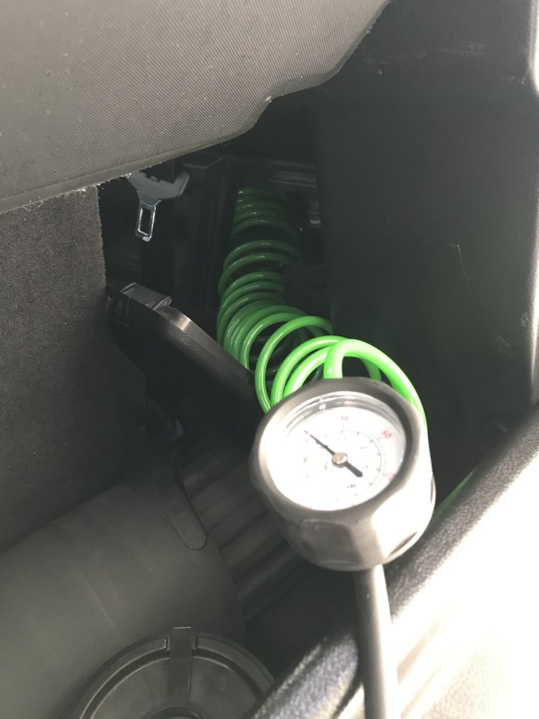

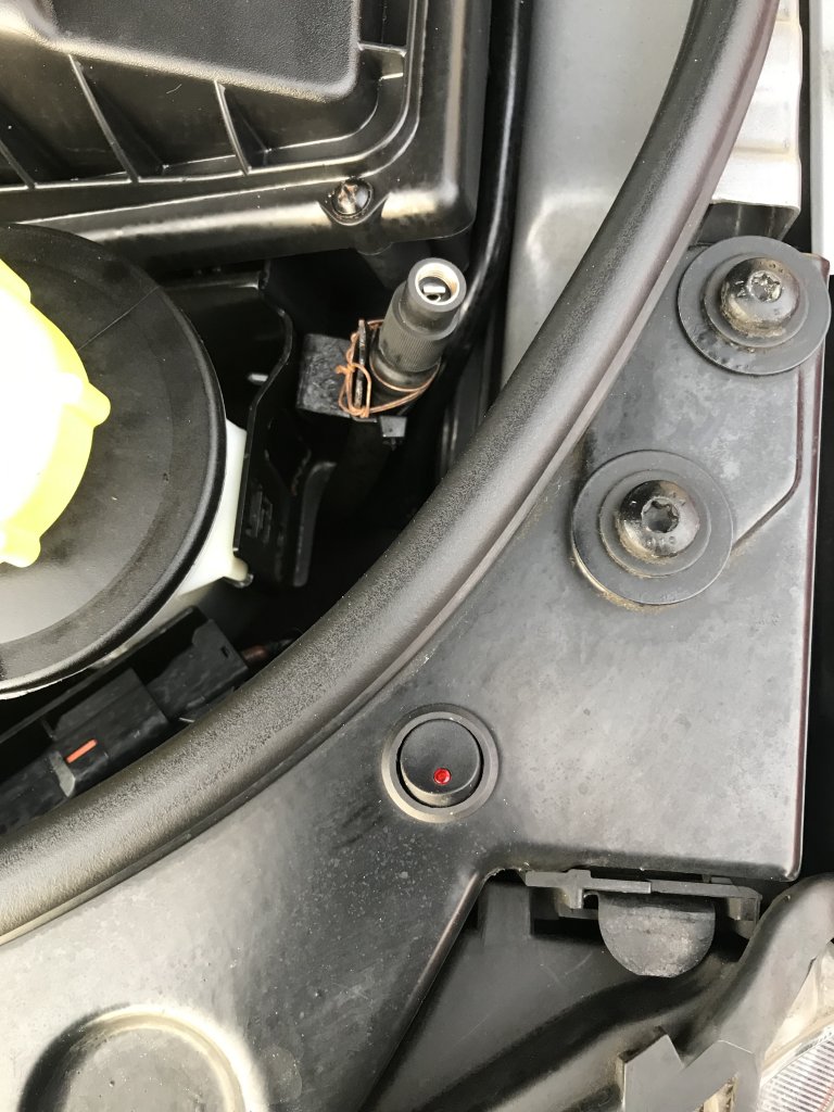

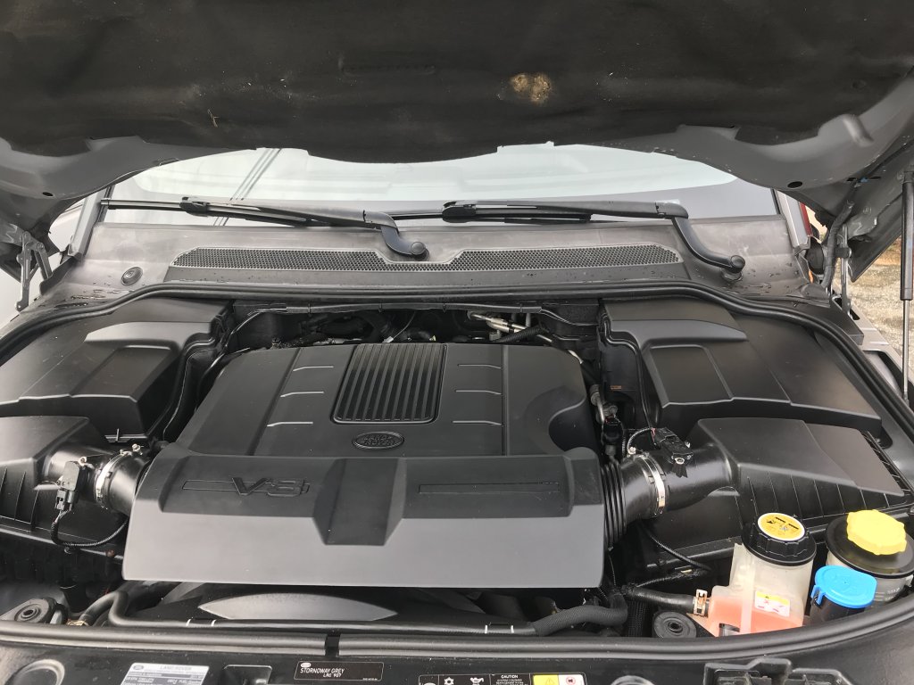

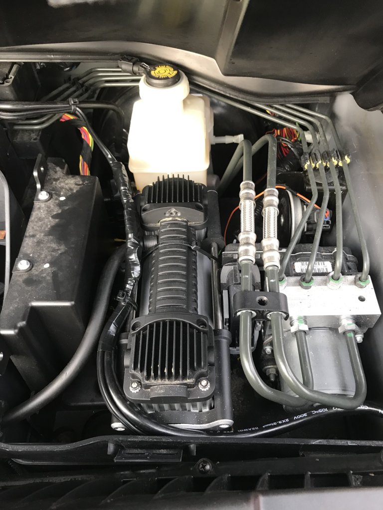

its a 12v high flow twin piston air compressor mounted inside the brake booster compartment with an outlet in the engine bay and one running to the back of the car. right now its only set up to inflate tires and use as an air blower( blow sand off the carpets and stuff) its hooked up directly to the battery with a 30amp inline fuse, its got an over temp sensor built in so if it runs for more than 25-30 min it automatically shuts off( didn't want the thing some how coming on while driving and burning up) air tank will eventually be installed on the passenger side under the car(just like the factory tank on the driver side) its a 3 gallon hot dog tank I found in my garage I think its from harbor freight but not sure. biggest thing is I hate seeing wires so its pretty much self contained inside that box with the exception of one power wire that it hidden along a bundle of wires that ran to the fuse box. from the outside you'd never know it was there (excuse the rusty safety wire holding the outlet in the engine bay the original clip broke while I was in NC uwharrie national forest on the trails and that all I had to put it back in place)

Wow, very interesting. Thanks for the detailed breakdown, much appreciated.

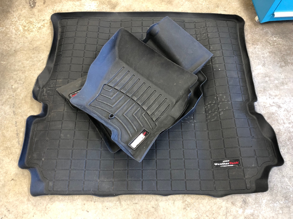

I've got a few accessories leftover from selling my LR4 if anyone is interested.
A set of Weathertech liners in great condition for the front, rear seats and cargo area._$250.

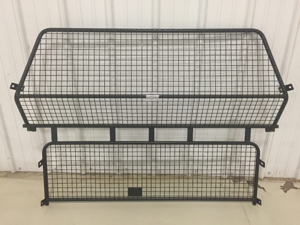

Also, a genuine Land Rover cargo barrier/pet barrier._$250
*I tried requesting permission to post in Classifieds but never got a response.
*barrier photo is not mine, but it's the same.

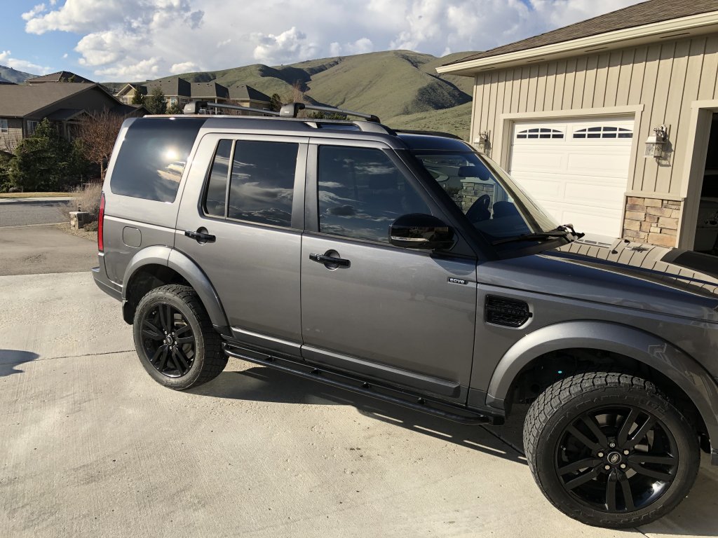

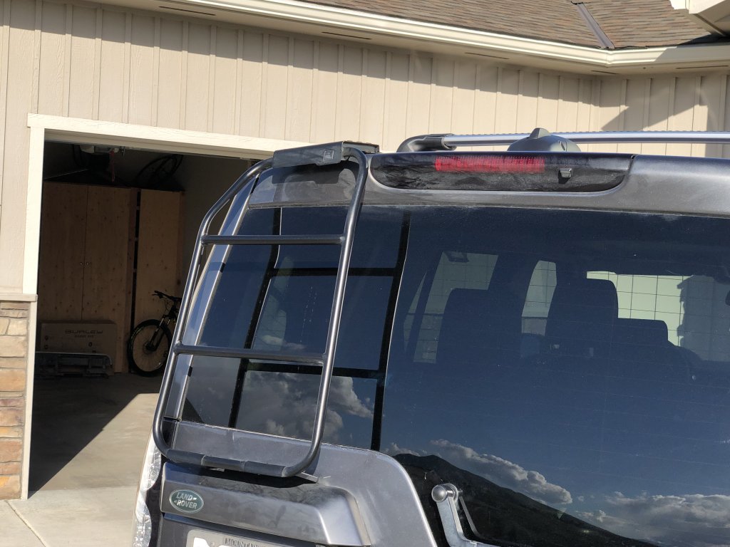

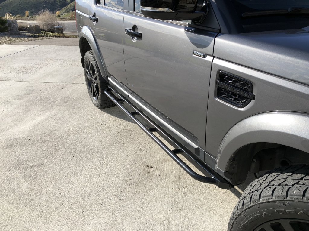

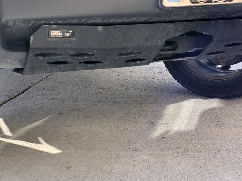

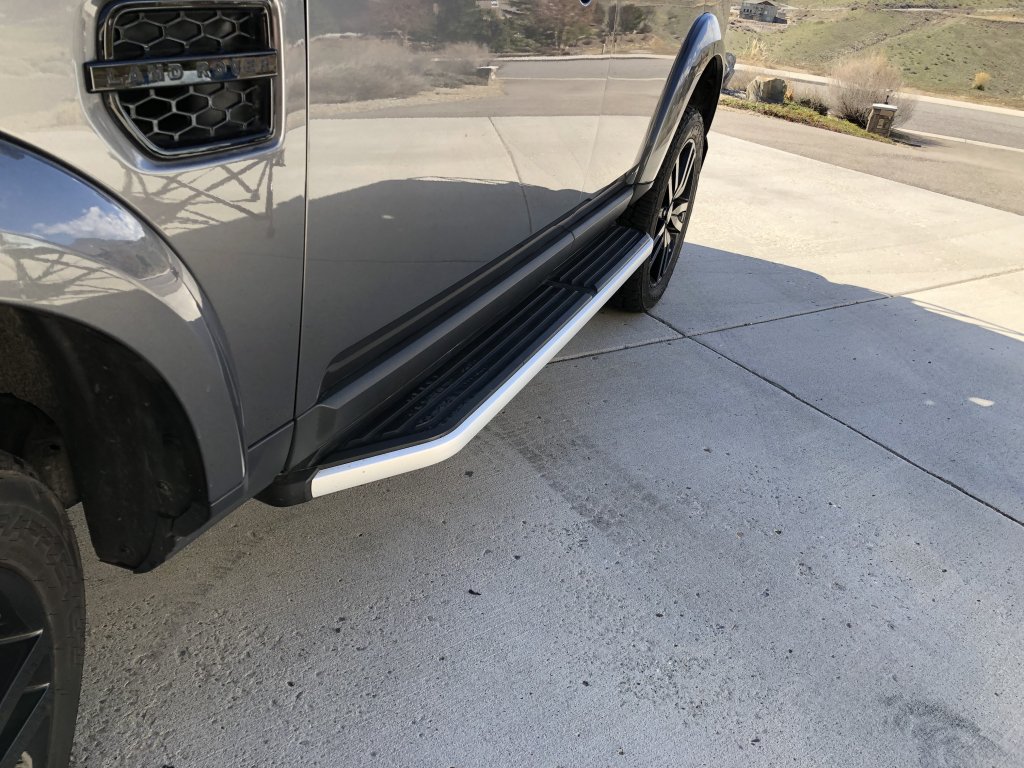

I have had my LR4 for 2 years but I’m not getting around to upgrading. Installed front runner bash guard and ladder a few weeks ago. Put the voyager sliders on today. They look much better than the factory steps and will be less likely to get hung up (see my avatar). Also have terra grappler g2 on since the fall
