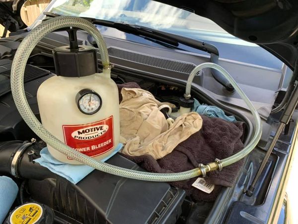

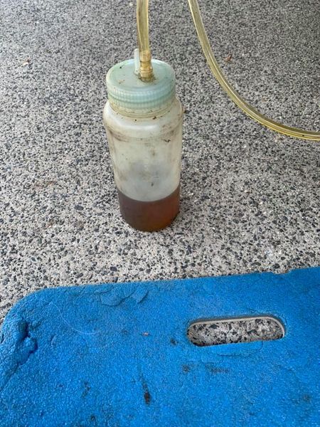

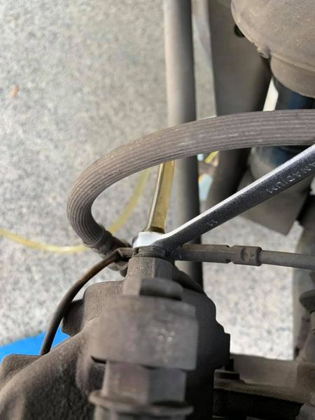

I did a brake flush with a Motive bleeder, have been using those for over 20 years and as long as the hoses are good, it works great for "one man job". Was having similar issues with hard pedal and flushing it fixed it. Old fluid was reddish brown, new one is apple juice. You only need one liter to do this, using a syringe to remove the fluid from the reservoir, refill it with clean fluid, connect the Motive and pressurize it. Then work from farthest tire to front driver.
Old fluid coloring, rear passenger caliper takes the longest to flush out.
New fluid coming from hose, nice and clear.
Thanks for confirming! I have a similar unit to the Motive and it works great on my other European cars. I've been wondering if any special procedures were needed on the LR4 (some newer vehicles require these), or if it was a simple pressure bleed. Guess I need to buy some of that watery low-viscosity fluid and get cracking on this.
