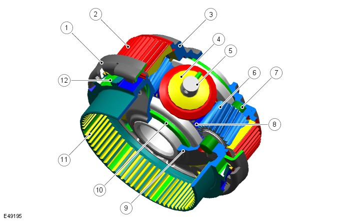

Right now the front tyres are smaller than the rears since they are worn.
One a single axles it doesn't matter if there are different sized tyres since the differential handles the different speeds.
If the front and rear axles have different sizes the question is whether the central differential can handle this. I would assume so if the difference is minor (like worn tyres) but not if the wheels were completely different. The diff could handle it for a while but might overheat.
The question then is whether the central transfer box is a differential or not and I can't actually find out! In the Disco2 it was but is the Disco4 any different? The workshop manual is not very clear.
If it is a diff then the tyre issue is solved and I not that a lot of the 4x4 diagrams used by garages don't actually show a central differential which might be why this idea has arisen.
sceh
May 23, 2016
60
Indeed there is a central diff separate from the transfer mechanism. Ergo, tyres sizes are pretty irrelevant?
