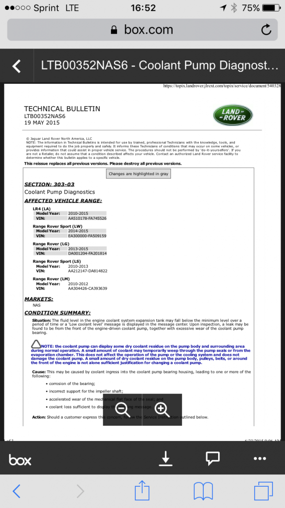

Here is the TSB. My question is whether or not the dealer will perform the repair at no cost.
My dealer told me today that my extended warranty would cover the repair, but that I would still need to pay the deductible. Is this the case or should I not have to come out of pocket?

In my case, any time I trigger the extended warranty I have to pay the deductible.. Which has been painless so far, as the $2K in repairs has been worth the $100. :biggrin:
