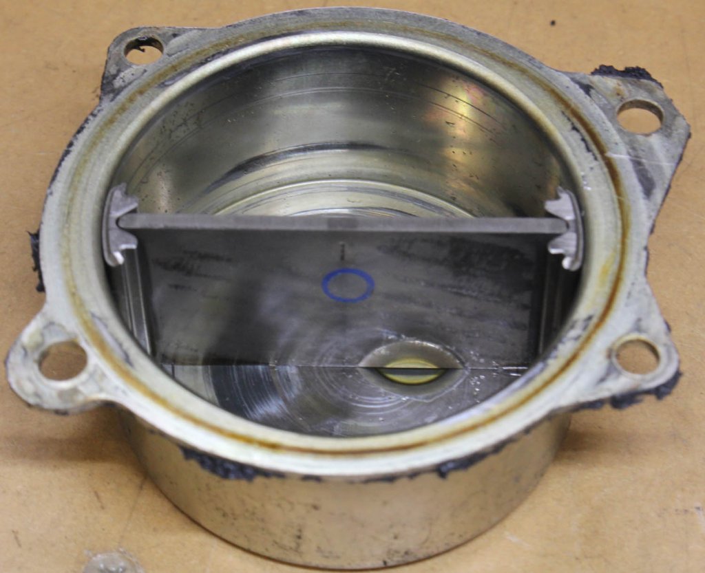

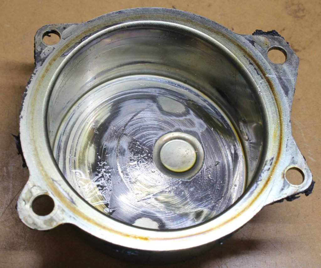

Two more pics, of the stamped-steel outer cover:

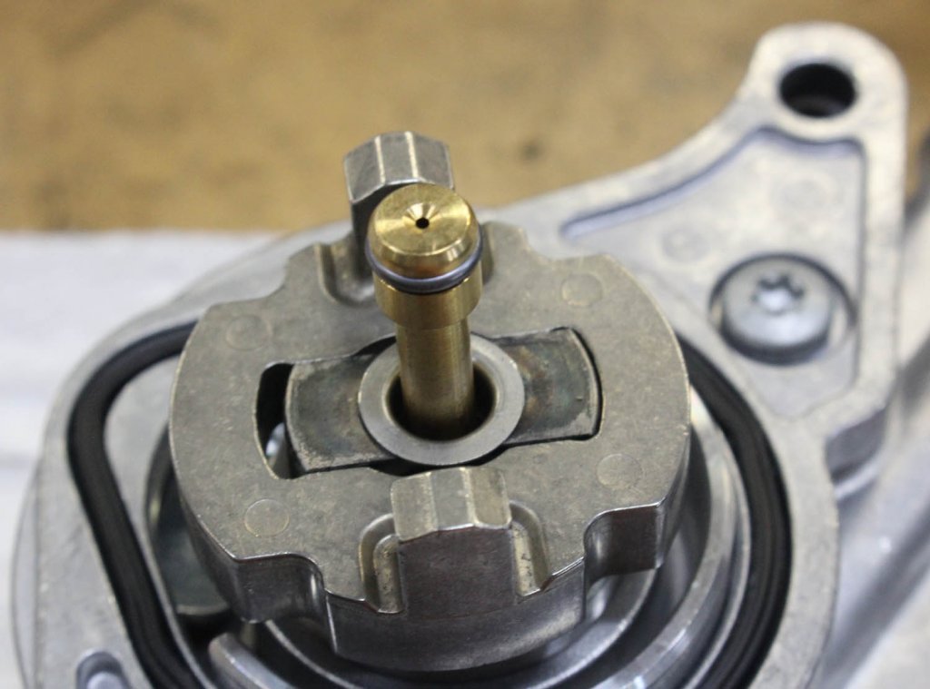

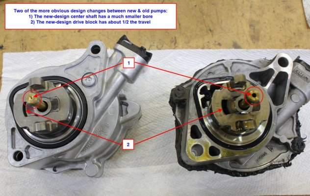

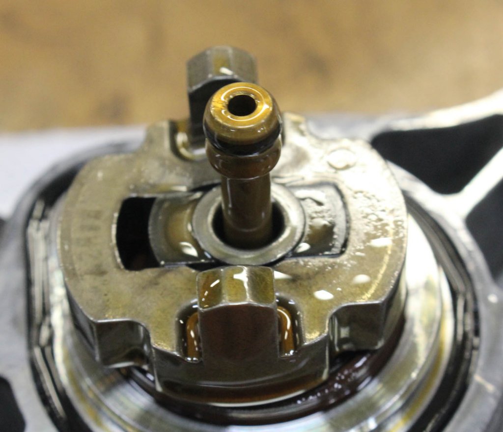

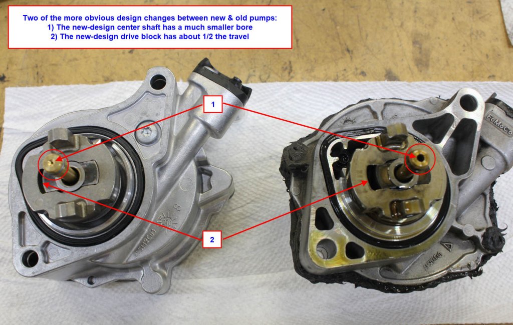

Few pics showing some differences between old & new designs.
