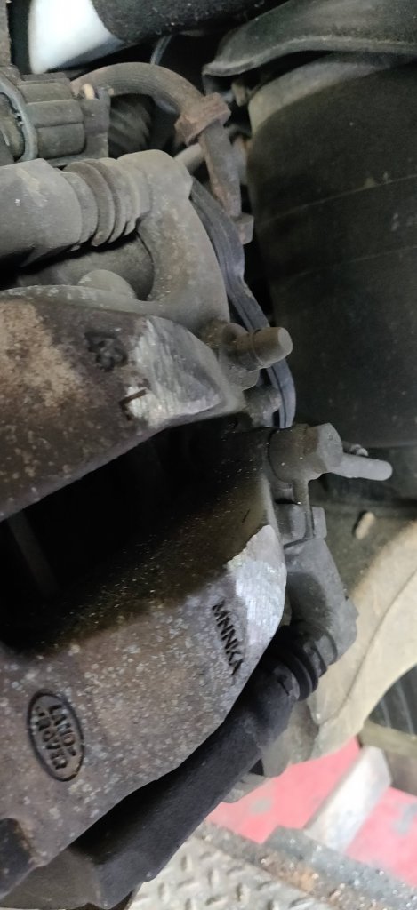

Is that a picture of the rear caliper?
Looking at the tuffant site, it seems to indicate that brake calipers with "5000/c" and "4999/c" will fit without modification.

I got them to work. I had to grind 1/16 off the peak of the rear caliper.

I am not sure. Mine was so close, it scratched the paint, but not the wheel base metal. But I knew with heating and cooling I had to give it at least 1/16 of clearance.
I did all the research your doing. Tuffant and all. I don't really know why mine barely touched.

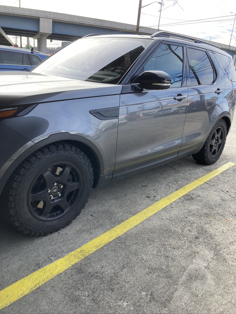

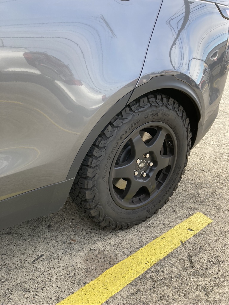

Finally got my tires and 18"compo's together. Very happy with the combo.BFG ALL TERRAIN T/A KO2
LT265 /60 R18.

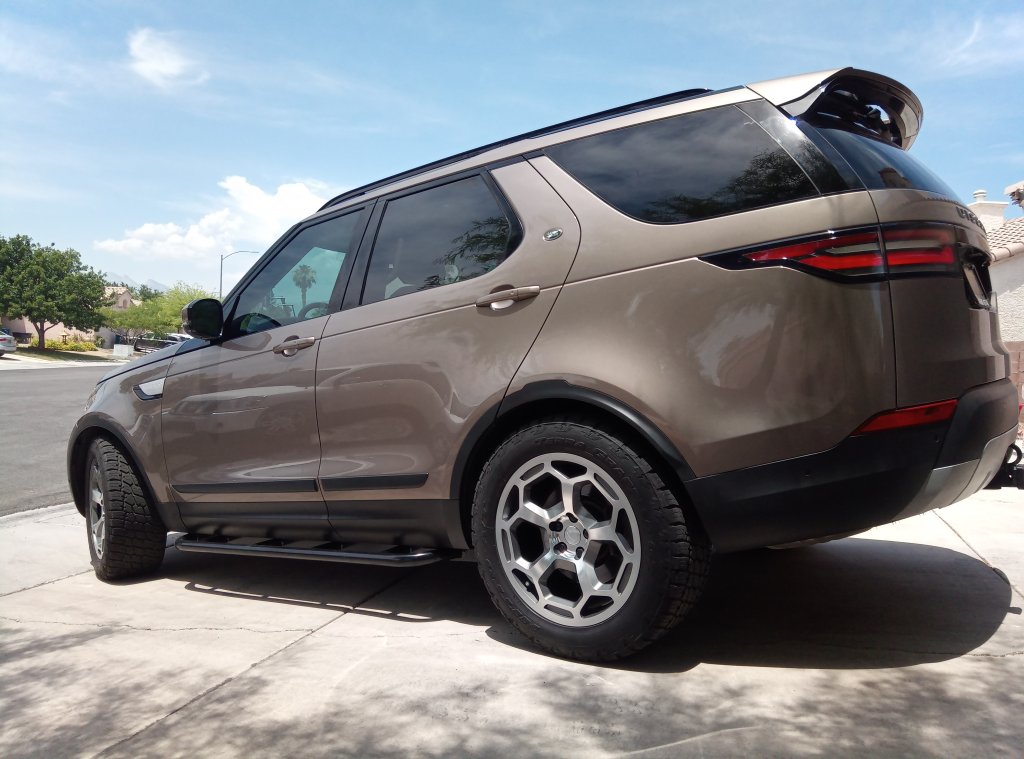

You could easily install larger tires. I have 285/50-20 Nitto Terra Grappler G2s on 20" x 9.5" wheels (including the spare) with no lift, no spacers, and no clearance problems. Comparing your tires to mine at https://www.wheel-size.com/calc/?wh...-18X7.5ET40&fcl=50mm&wcl=30mm&scl=50mm&sr=0mm shows that you have .62" more sidewall height (and greater air-down capability). Get some rock sliders on that beautiful D5 if you plan on tackling serious trails.
