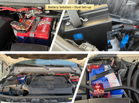

Apr 28, 2025
Morro Bay CA
I completed my dual battery setup. I had to deviate from the posted method of putting the ECU in a protected case under the brake lines. Instead I attached the horn to another bolt farther back and tucked the control module still under the brake lines but in its original case. I then repurposed the ECU protective seath to house my Victron DC-DC charger to then use the AGM battery to charge the Lithium 135Ah accessory battery.
I have a G3 GAP IIDX BT diagnostic tool and cleared the faults, but I'm still getting a charging system fault even though I went back to the origina OEM ground cable. I tried a different profile using the GAP tool since I went lead acid to AGM.
Anyone familiar with the GAP IID Tool and any programming needed with an AGM upgrade?
A picture for reference.
