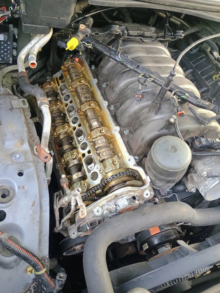

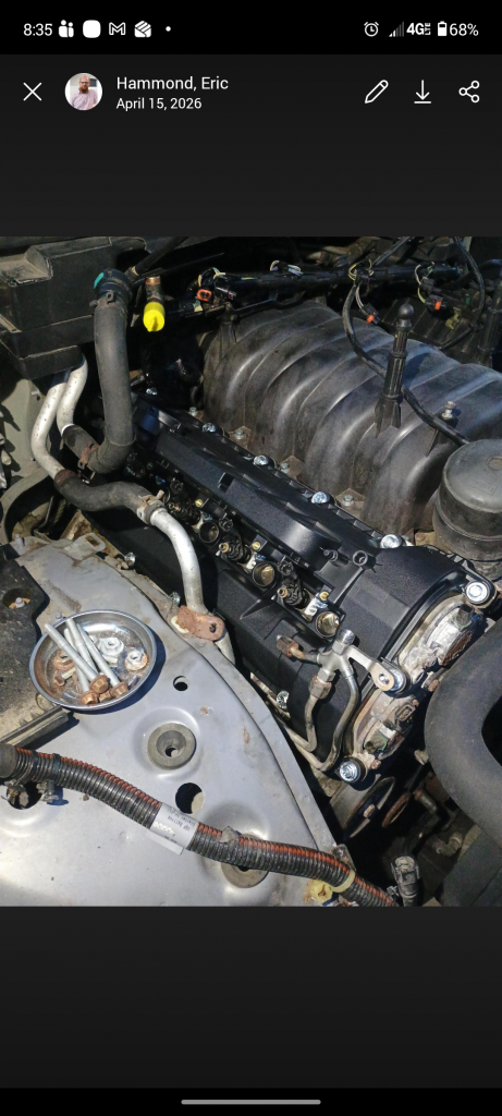

Second set of injectors out. That rear one was hard to get a bite on. So I pulled the o-ring and nylon washer off. That allowed me to get bite with standard puller and pop it. So no results for " new" screw puller tool. Back to Amazoon they go.
But, can I just say those two rear drivers 10mm for valve cover....terrible. They were more fuss than the injector.
