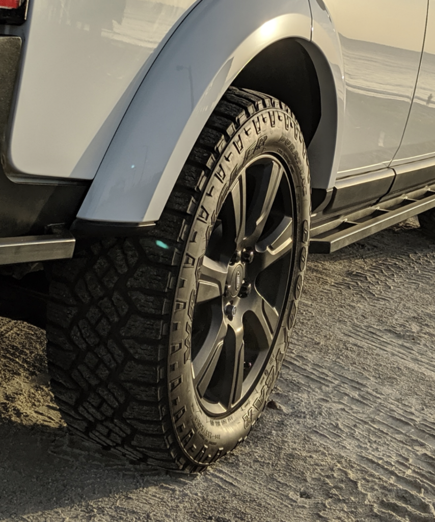

I moved my OEM TPMS from the 19s on my LR4 to the LR3/18s that I installed. They went over fine.

I assume that means the LR3 18s are TPMS ready. Most (all?) of the steelies and the Compos, to my knowledge, are not.
The LR3 18s require spacers, yes?
Yes. I wrote about this in a few other threads. BORA 30mm, from Motorsport Tech, based on Scott Brady's Overland Journal truck. Still had to grind about 1mm off the front brake calipers to fit.
