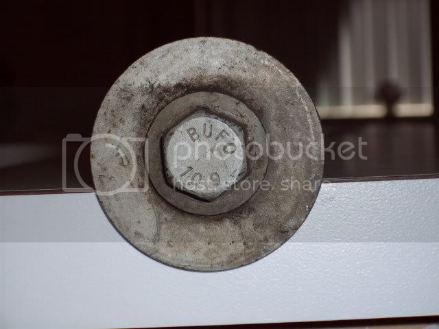

I have searched and searched and cannot find an uprated bolt that is not a socket-head cap screw. I've got some people at fastener shops looking for one for me.

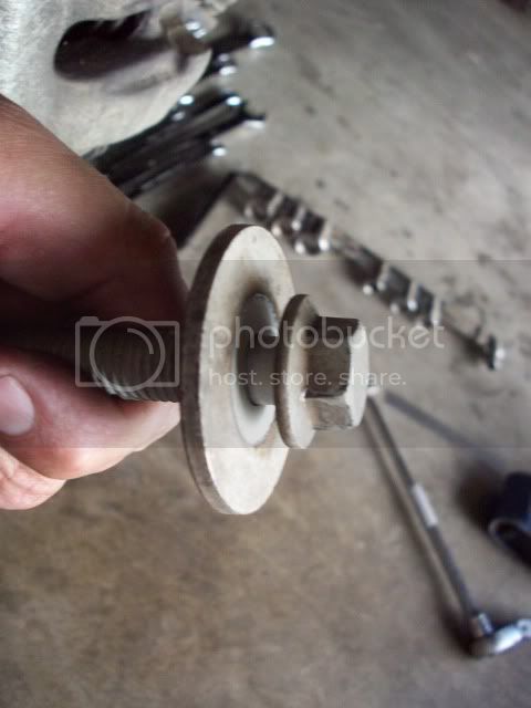

BFH: By your description, sounds like this bolt threads into the control arm and torques down. So there is no nut or anything like that....supid question, huh?
...does that spindle rod or whatever just stay up there? Do I need to use something to prop it up? Does anything come undone when you remove the bolt? That's really my only nightmare in working on this rig....taking out a bolt and having a bunch of $hit "come unglued" and be unable to put it back together!

Houm - the bolt threads into the spindle assembly, not the control arm. The arm is just a passive component of this assembly. It does have a steel bushing which mates up to the "washer" of the bolt to prevent over compressing during the torque procedure. When the bolt is pulled out, the arm is somewhat free to move down if you force it. The other end is connected to the frame and the length is controlled by the jamb nut on the threaded end. You have to loosen the jamb nut to really screw things up - so don't. The arm just sits in the same position unless you play with it - so don't. ROFL!

so it's a simple unscrew, replace, torque down?

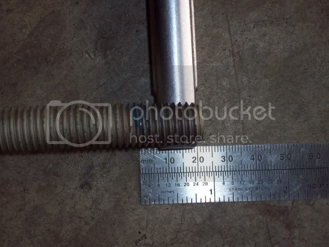

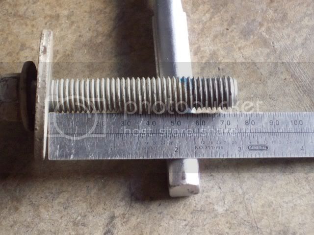

I have found a 12.9 but it's a partially-threaded bolt (40 mm of threads) and it is a socket-head type of cap screw. Would that be better than the factory? It IS stronger.
That's what it appears to me. Pretty simple operation. It sounds like only 25mm of threads are used, so if you have at least 30mm of threads, you should be fine! Make sure you get an extra HD washer too.

Here's the scoop - uprating this bolt may be actually cause more issues than it solves. In talking to my specialty guy, there is a 12.9 special ordered bolt available. He recommends staying away from the 12.9 for a good reason. Yes, the 12.9 does have a higher Tensile Strength rating than a 10.9, but the type of application we are using it for creates issues.
The strength rating is based on pull out values which are applied to the bolt along it's longitudinal axis. The force being applied to the bolt in our application is a shear condition, which lays 90* to that same axis. The 12.9 is more "brittle" than lower rated bolts and will deform less than say a Grade 5, 8 or 10.9 when being subjected to side or shear forces prior to failure. Yes, the Grade 12.9 has higher hold down values, but our application has little to do with true "holding power". We're just locating a suspension link.
I'm sticking to the OEM 10.9. LR Part# RYG500073 - 5 bucks each. Done.
