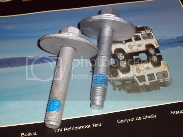

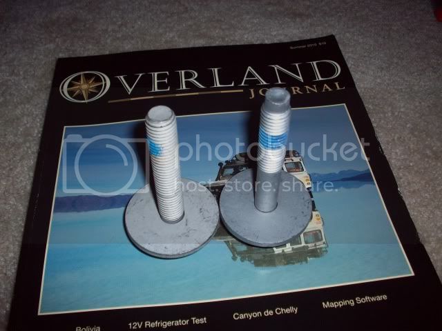

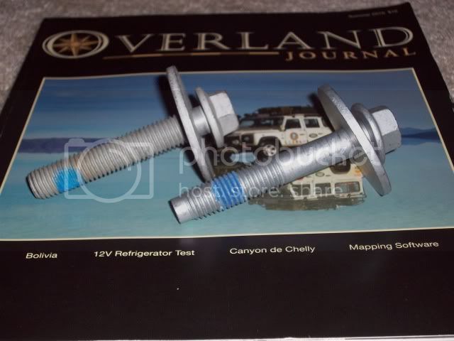

I just picked up my passenger side bolt and Lo and Behold, it's different. The OLD part number is RYG500073. The NEW part number is RYG501580. It's longer by the length of the un-threaded tip and lacks threading the entire length. Answers that argument. I'll try to install them tonight now that's it's no longer triple digits outside.
Houm_WA
Jan 6, 2006
3,948
261
Is it just me or do the materials look different? The new one just looks more "glossy." Is one plated and the other not?
blackforestham
Feb 4, 2010
338
They both seem to have some sort of EG coating and both are 10.9's. I'd assume the same material composition. But, now I can give the GF the old Burt Reynolds look and say "Have I got a shiny bolt for you!".
