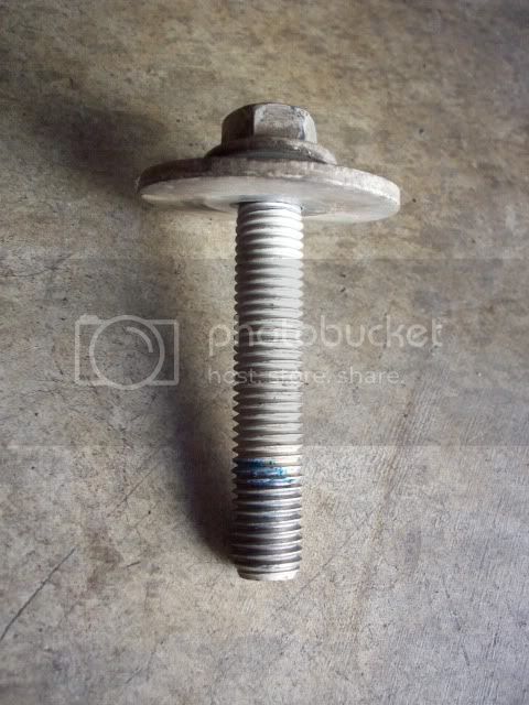

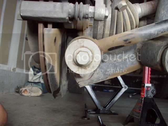

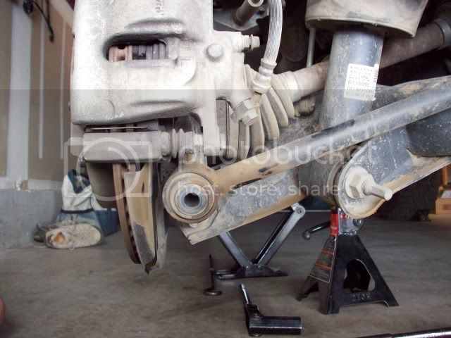

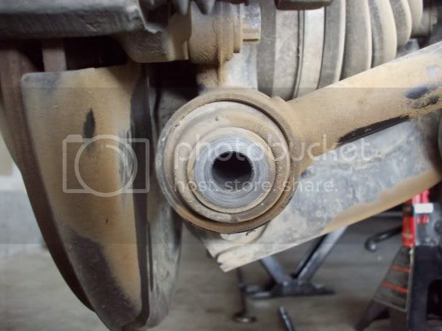

I started part 1 of the bolt replacement and hopeful uprating. I found it hard to believe that mine was torqued down to 129 lb/ft. I can see that mine were tightened or loosened a couple of times. I assume that was the result of an alignment. The bolt faces were slightly rounded due to a loose fitting socket. I also assume that impact tools were used to T/L the bolt. This may or may not be bad for the bolt?? Anyways, the bolt looked fine upon inspection. Loctite Blue was used so I will use the same upon re-installation of new hardware. My local specialty bolt shop produces jigs for decking, honing and building Nascar heads and engines. They have every type of known fastener in the biz. If they don't have an uprated bolt, it may not exist. I'll post up tomorrow after work and let you guys know.
Removal was nothing. It took longer to take off my tire than remove the actual bolt. I'm sure you can do this with the tire on but I like to lay there and inspect as many things as I can with the wheel removed. I did find a small tear in the lower rubber boot of the shock assembly. I don't think this an issue as it's purpose is to keep debris out - not provide an air tight seal to the system. I'll keep an eye on it though. 18mm 12pt socket is the ticket. The bolt only seems to actually thread into the assembly 20-25mm's. The rest of the bolt clearly does not need to be threaded. It's my opinion that a typical fender washer is probably too thin to handle the required ft/lb torque. At 4mm's thick, this feels more like a bearing plate than a washer.
