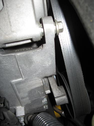

ok here's a pic, the larger pulley is the one that looks slightly tweeked to me causing the belt on the smaller pulley to be hanging on the edge, again its incredibly loud trying to drive the truck like this, thank you so much for your input!

That is the tensioner at least that is what it looks like... around $80 in the part and 5 minutes work to change it.

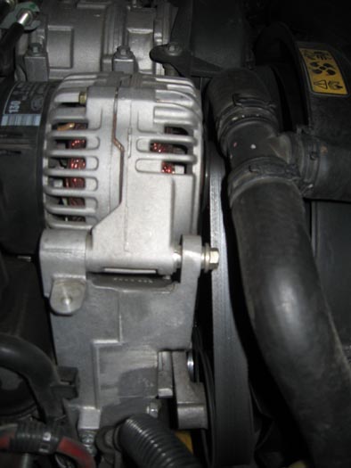

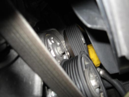

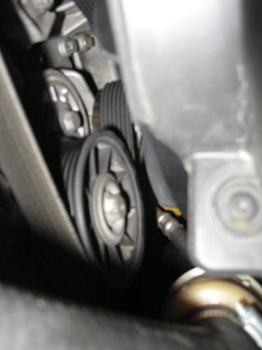

Wow! thanks alot I will take it to another shop and see what they say. I'll attach some of the other photo's let me know if you see anything else. Thank you again. -Dan

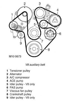

Idler pulley, not tensioner... sorry my mistake.
