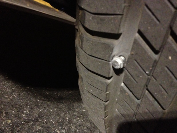

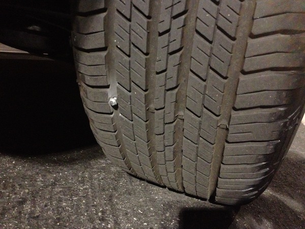

Only 1070 miles, and:
Local tire shop says that can be fixed for $30, will have to take the tire off the wheel and patch from inside. Its a rear wheel.
Question is, should i get a new tire if i can get it under some sort of warranty? And if i do, would it be a good idea to run a brand new tire with no grip at all alongside three tires with 1K miles which should have some grip by now.

Just get it patched for 30 bucks and forget about it, it's quick, safe (as long as on the tread and nowhere near the sidewall) and permanent. Even if your tires did come with some sort of hazard warranty, they most likely would not approve a replacement tire for such tiny and easily repairable damage.
PS: Tell the tire shop to take it easy with their impact guns on your lug nuts, and see if they can torque them manually.

I get those weekly. You'll be fine. The only issue is if it hits the sidewall. I had to replace a tire at 1,500 miles.
