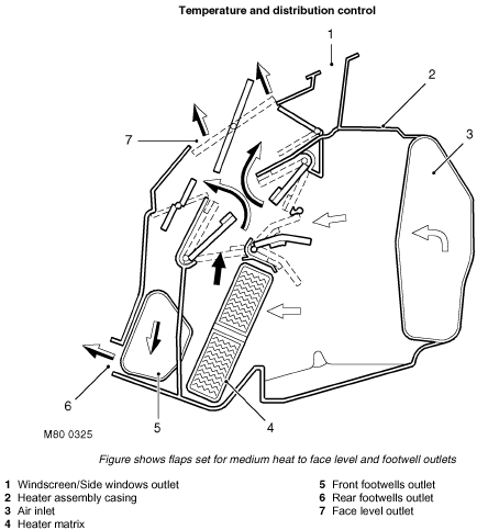

Basically when it is digital it is vacuum IIRC... I may be able to post the pic... let me see.
joey
Custom Rover Accessories
Staff member
Jun 28, 2004
10,495
188
Hope this helps, but not sure.
colopedo
Dec 18, 2007
thanks much! that makes it look like it's all one big apparatus though...know if it can be dismantled?
