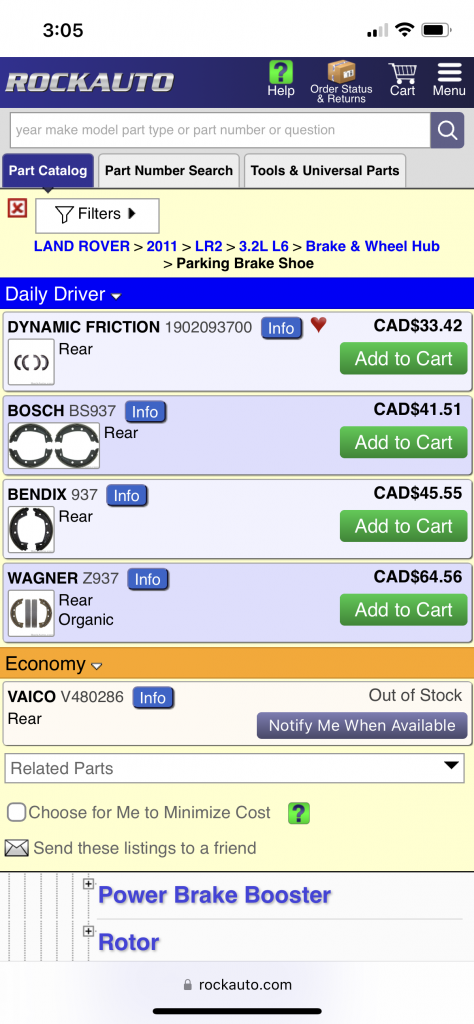

Below is a screenshot from rock auto in the US . I know you are in the uk but could you not try somewhere other than the LR dealer and try to source any of those part numbers?
