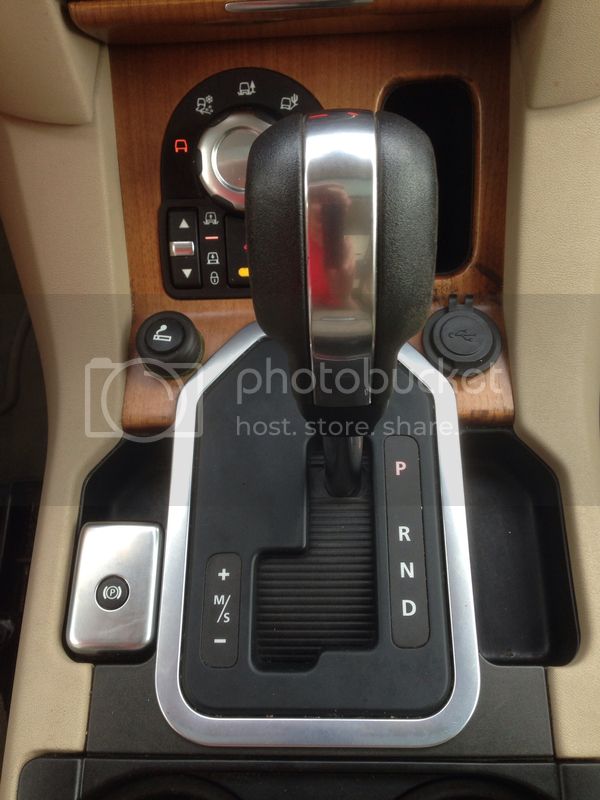

I just went out and installed my dual USB port. Only tip I have is I took a Dremel to the hole once I took the stock cig lighter out. The USB port is a touch bigger than the stock cig lighter. Other than that, it was pretty straight forward.

Yeah I filed mine as well. Just a touch but so nice to have 2 USB ports up front. I'm mad at myself though as I forgot to make it an always hot port. I was running always hot wires for the HAM radio and should have run an extra set. I don't want to splice off the HAM circuit as I think it isn't good for the radio and I want them separately fused.

I thought about that, as I added a fuse block in the rear I figured it would be easy enough to run the wires. I may just jump the relay.
