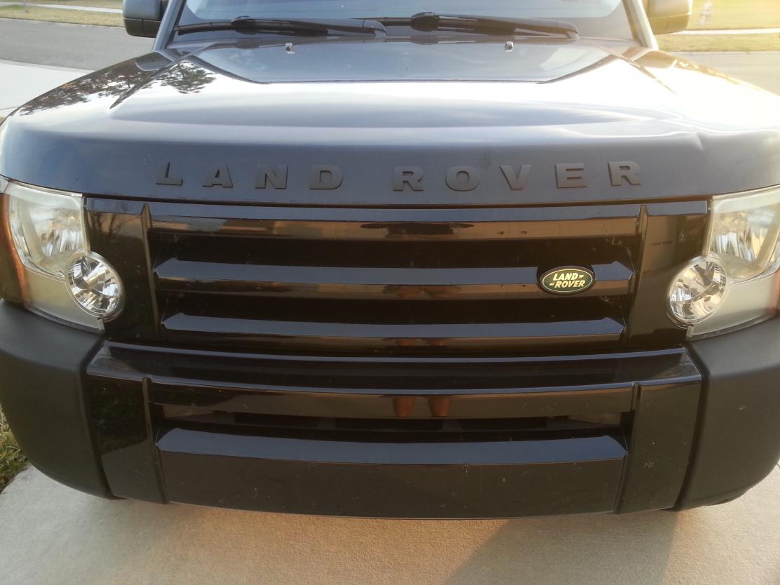

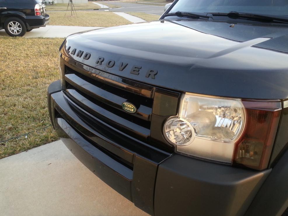

The letters were easy... I was really impressed how the dip peeled away underneath the letters. No masking is needed like you would for spray paint. For inside some of the letters, I uesd a toothpick to get a break in the surface and then it peeled right out.

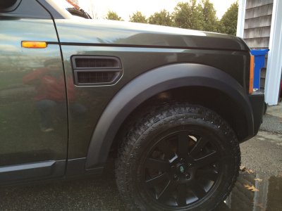

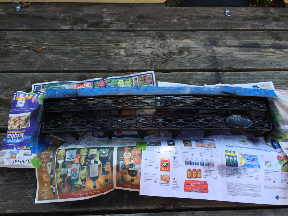

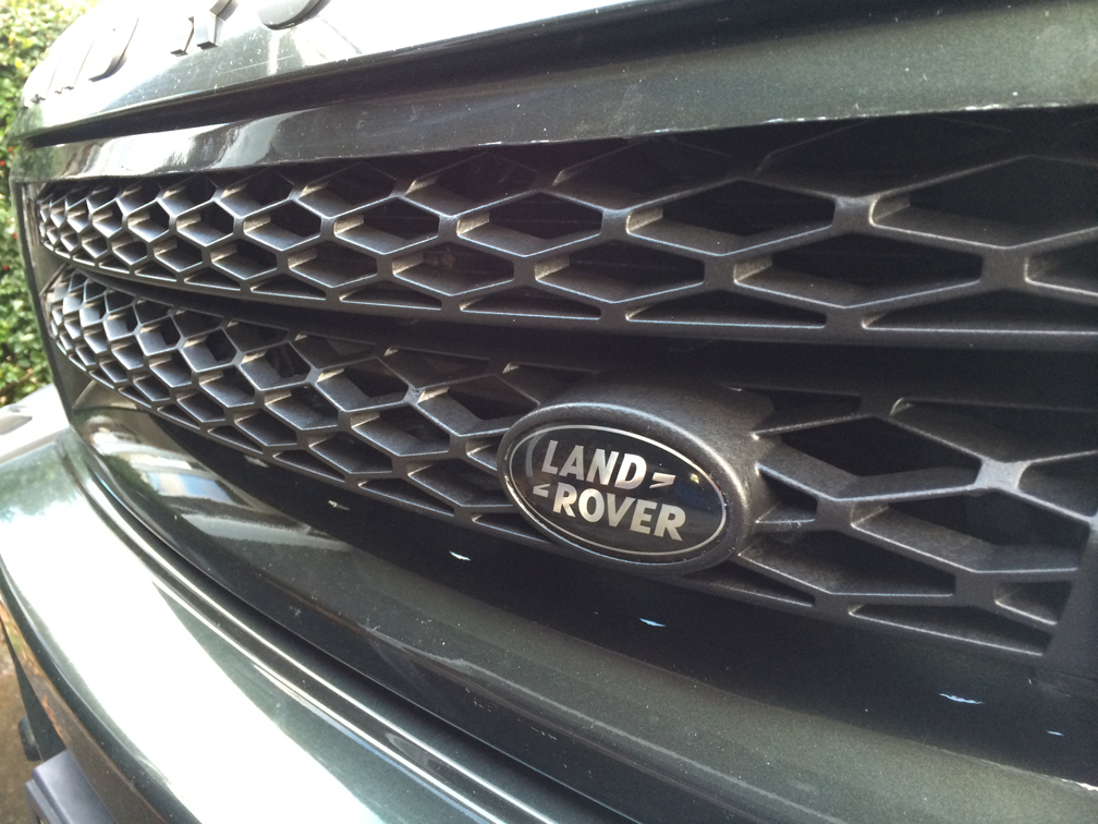

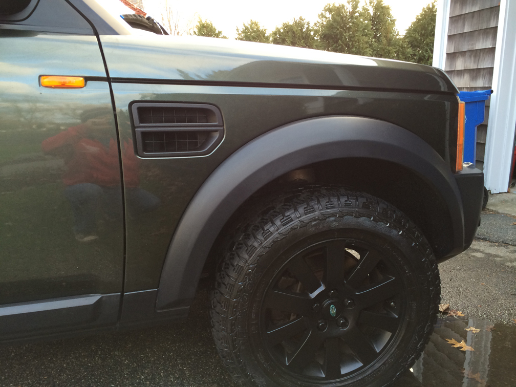

Thanks Toddjb122, here's what I did to my truck today, just finished about an hour ago.
Plastidipped grill black and redid my side vents with plastidip. I also hit up all my black trim with armor all black trim restorer.

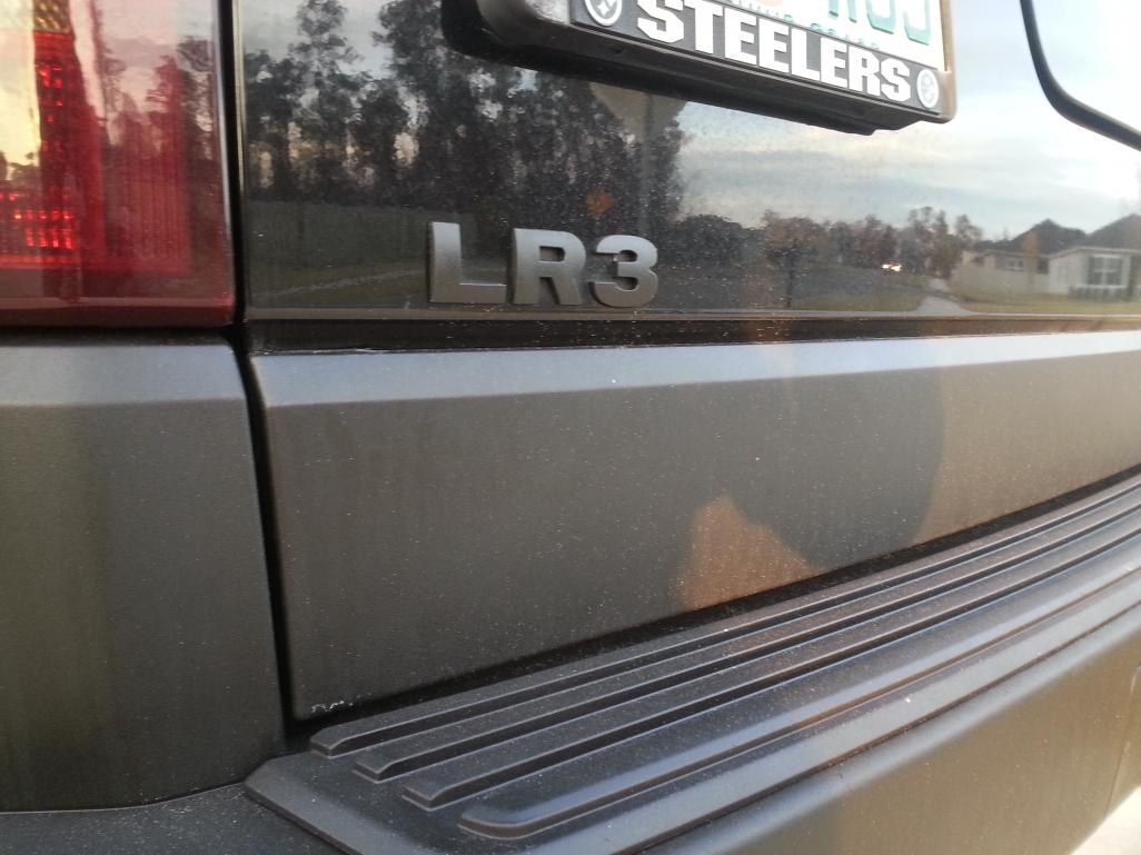

Here are a few pics of the letters... turned out great with 5 coats. No cutting or trimming with a blade is required. It just peels cleanly right at the crease of the letter and hood.

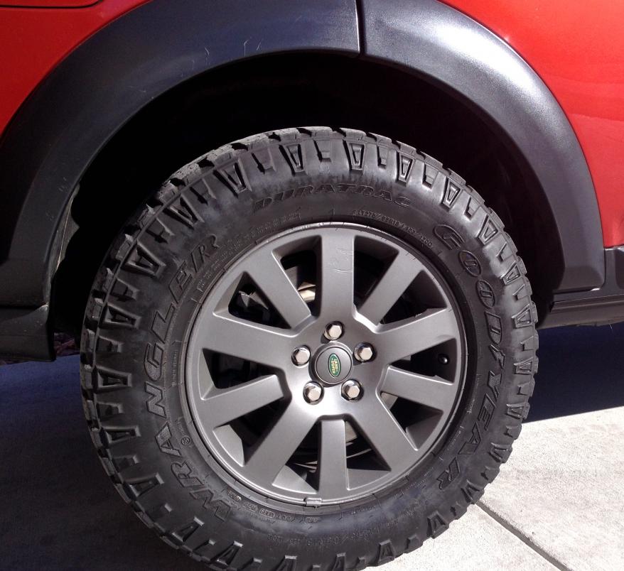

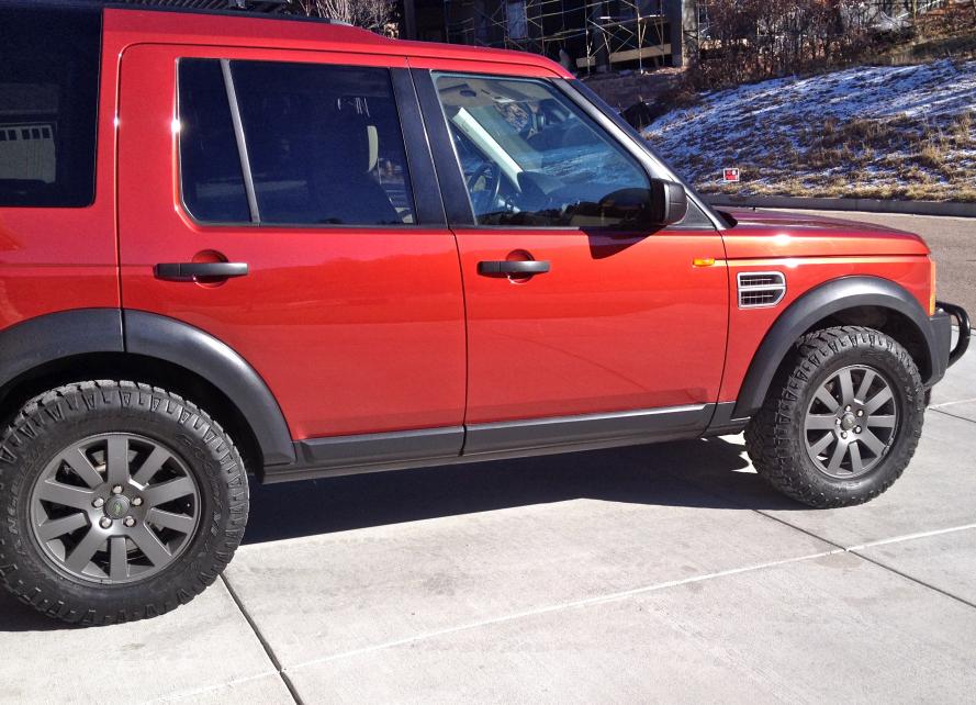

Did my wheels with their new color Anthracite Grey....love the color. I did take off each wheel and did the insides too. Used three cans of spray.

I like the grey, pretty slick. :cool: Now the question now is to glossify or not to glossify??
