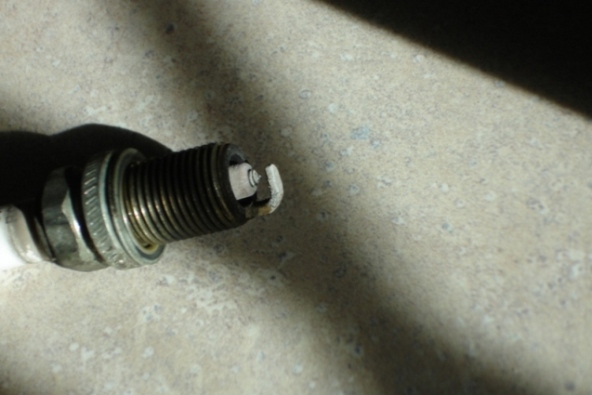

Changed the plugs today and as expected, I noticed some white crust. Please review the plug image as attached. (#2 position) This is about the worst of the bunch, but they all had the same issue. I beleive this to be a sign of coolant burning up. I've been topping off coolant more than I think is acceptable, each week. About a 1/4 cup. No smoke, no signs of coolant around engine area.
How severe does this appear, and how immediately neccessary is the looming head gasket repair?

Actually, it seems this is rather normal and actually a sign of a properly tuned engine. The white 'crust' so to speak, is not what I originally thought it to be.
So my never ending search for the cause of coolant loss continues. Not fun.
