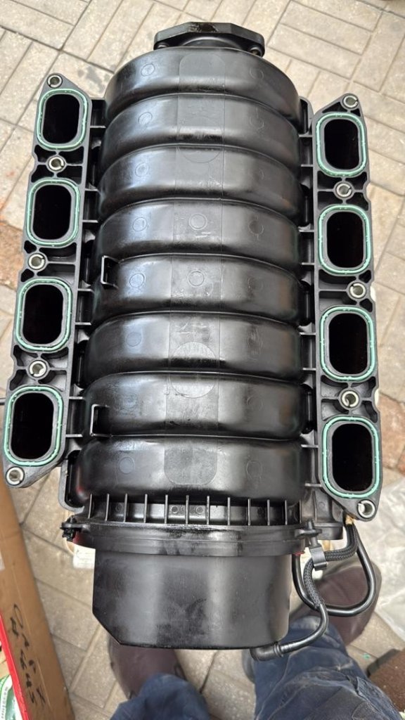

I used ChatGPT to create print version, I like a bit of an old fashion type of instruction. I attempted to iron out the guide as best as possible- I will be replacing Serpentine Belt, cooling hose, Intake Gasket and Plenum and perhaps a few more items. Did I miss anything?

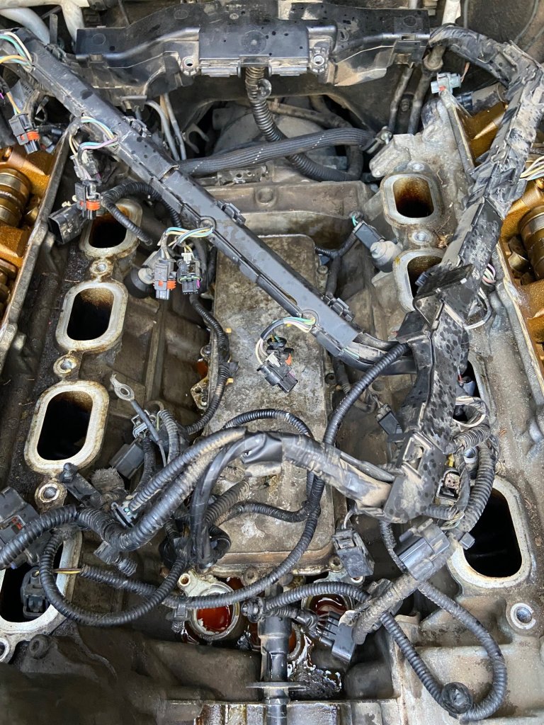

1. as @djkaosone notes: use only OEM or better and get from a reputable seller. I use Atlantic British for a lot of my parts and they are excellent. In fact, I had replaced a bunch of coolant stuff about a year ago (summer 2024) to include a "new" water pump (which I must have gotten from Amazon). Well, the pump failed pretty hard (internal gasket failure because that gasket is paper and not the proper metal kind which was slowly leaking coolant everywhere) and I didn't even know until we pulled it as part of a major service presently ongoing. This is actually the third water pump in my truck (the first was the factory install that catastrophically failed on me Christmas Eve 2023 and the dealer replaced under warranty; the second was that one which I replaced last summer and had not yet failed but was looking rough; I just bought a fourth from Atlantic British to replace the one installed last summer and that I should have sourced from them to begin with). I have photos of the failed pump and we are going to try and tear that pump apart and rebuild it with better gaskets to see what happens.
