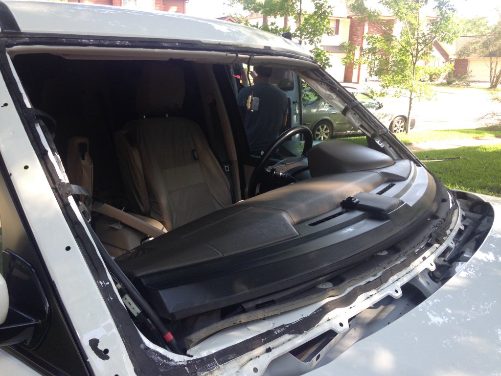

The blue tab coolant line release on the passenger side (US) rear crossover is tight even with everything out.
And the hardest bolt on the rear crossover is on the passenger side (US), as I seem to recall it was the bottom one.
Can't imagine actually trying to properly torque that bolt without sufficient access. It was hard enough even with access because of that A/C bracket.
The windshield cowling is a piece of plastic, sure that's easy, but it covers sheet metal and won't get you anything - see attached photo.
If the cowling comes off just replace it with a new one because at 120K miles it has warped and the seal on the windshield has almost certainly failed. Based on owning 3 of these LR4's, that warp spot is repeatably worst on the passenger side (US) just above the scoop for the air intake. Leaks at that point will put water on the passenger floor boards.
Additionally, at 120K the coupling on the SC is shot and needs to be replaced. It is just possible to do that job without removing the SC but draining the oil is easier and more complete when SC is removed.

In addition to 16FujiDisco comments about children - which are true btw...

Work is complete. No SC removal.
When I picked it up, I questioned him about the cowling removal, saying "isn't it all sheet metal under there"? He said yes, there is sheet metal, but it gives enough clearance to assist with the job.
I also asked about "what tool" he needed but didn't have in order to do the SC removal/front crossover work. He said the "tool" was the alignment pins, not just some torx and sockets.
Not sure why such conflicting opinions on here vs. mechanic about the need to remove the SC. Perhaps things like access under cowling, blind screw access, wiring looms, hard-to-reach release tabs, SC's, etc, are simpler for a professional mechanic with a lift vs. us shade tree mechanics?
