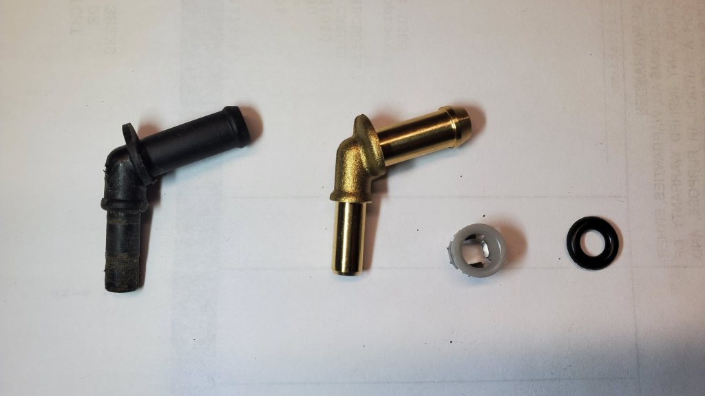

In the spirit of closure, I just wanted to wrap up this thread with the last repair that was made to stop the various coolant leaks (knock on wood). This weekend I replaced the small plastic elbow that attaches to the front of the water pump with the metal version. No more leaks. I am attaching a picture of the plastic one and the metal one (with the other pieces that came with it that I did not use) so you can see how they compare, and how I damaged the plastic one when trying to remove it from the water pump I just replaced. I should not have tried to re-use it in the new water pump, so I would highly recommend buying the metal version if you decide to replace your water pump (link in previous post). There is a good chance you will break it or damage it, like i did, when you try to remove it. You would be surprised how much coolant will leak from that fitting. Thanks to all of you for the advice and "shoulder to cry on". This issue almost broke me... not so much financially, but mentally.

@RoverTide their website says that the elbow doesn’t fit NA 5.0L motor and fits only the supercharged variants. it worked fine on yours without further modifications?
Rover Range
Jun 13, 2022
836
499
Texas
Coolant pumps are the same.
Not sure why they would say they are different.
