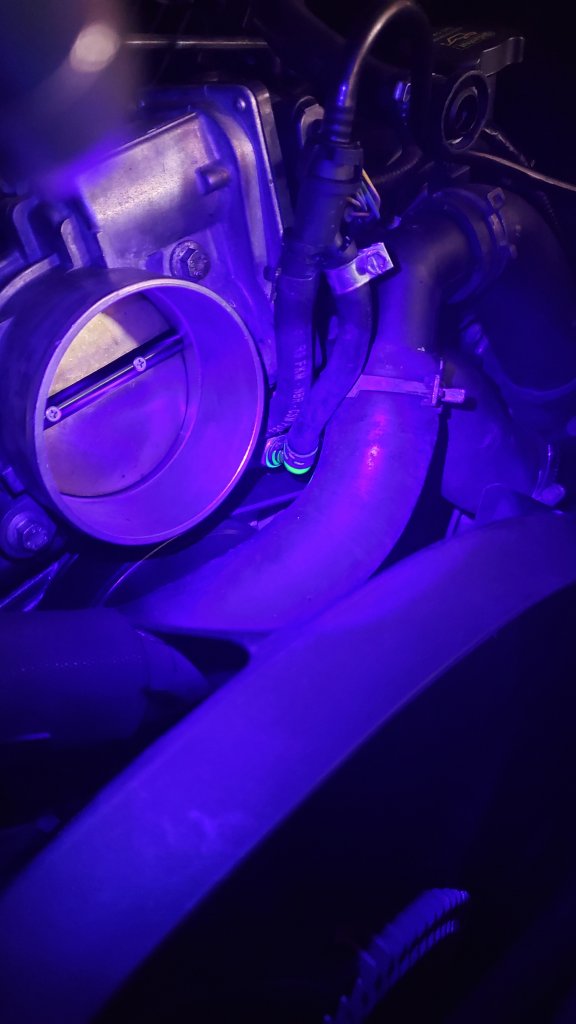

Found the leak.... Haven't attempted to fix it yet, as it is too late now, but hoping its the hose clamp and not the plastic elbow in the water pump. Crazy how much coolant can leak out of there.
Edit: I just realized I didn't report in this thread that the hose under the manifold was leaking previously, hence the coolant in the valley. Replaced that hose, and then this leak popped up. I swear the coolant is hell bent on trying to escape.
