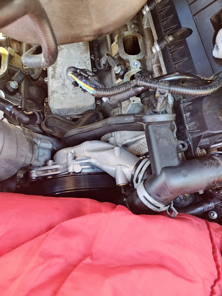

I'm trying to pull the front xover pipe and I'm hesitant about breaking the ******* off in the block. When I tug and pull, it doesn't budge. I tried a little pry action against that aluminum cooling fin device in the center of the block. Tried tugging from the front of the pipe where the hoses connect pulling up and side to side. Any tips for removing the front xover pipe?
Fair enough. Sucks you have to tear into a fresh repair.
True, but I found my front diff breather is missing and some of the brake fluid doesn't look like it was flushed out.
