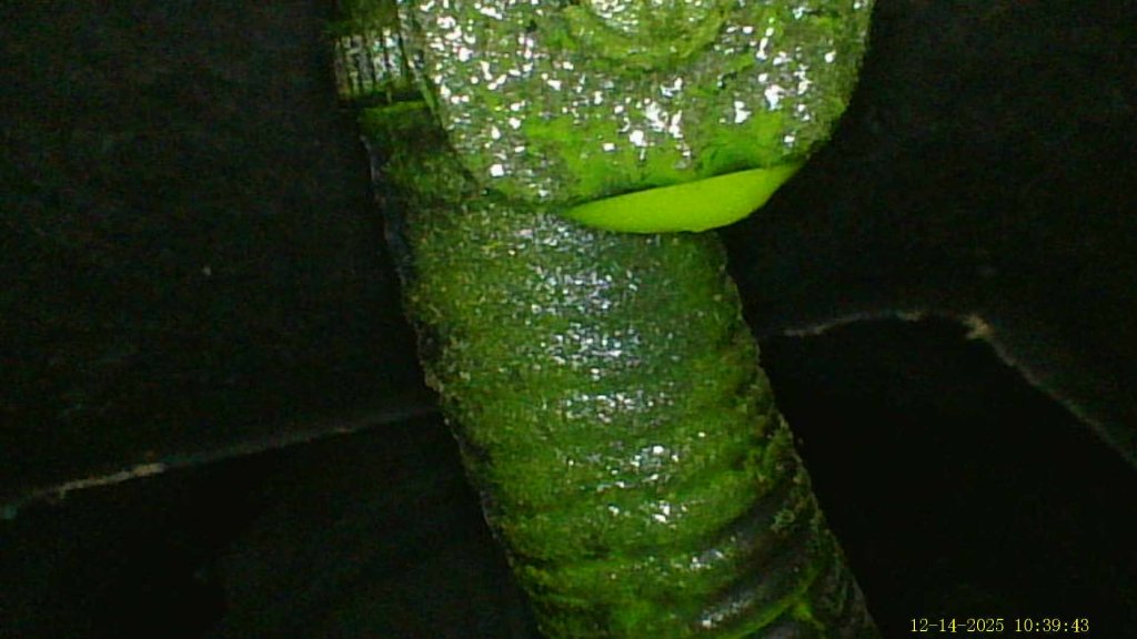

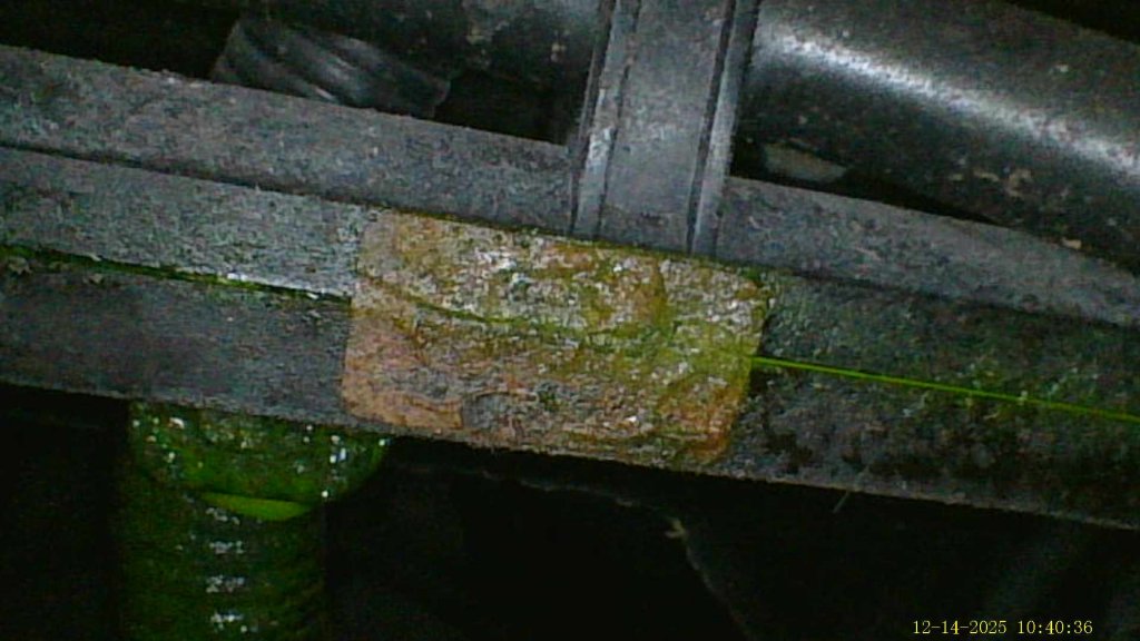

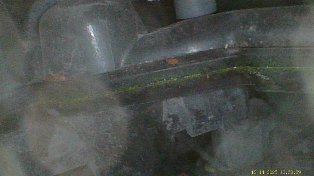

I recently replaced the main radiator that had a slight leak when I pressure tested the cooling system. I also replaced all the hoses, and the overflow container. However, I still had a slight smell of coolant after driving but no visible leaks.
I used my borescope camera to examine around the engine and discovered what I think are leaks in the rear crossover pipe that is the old, seamed style and I think original to the truck.
Just wanted to confirm that this is the pipe and it is leaking?

It’s a little hard to tell given the angles, but yes, that looks like what I remember the rear crossover pipe looking like. And regardless, you clearly have a leak back there that needs some attention.

Thanks. I was hoping the radiator leak was the only one. I will have to remove the supercharger for this repair. My plan is to change the spark plugs and injectors while I have it all opened up.

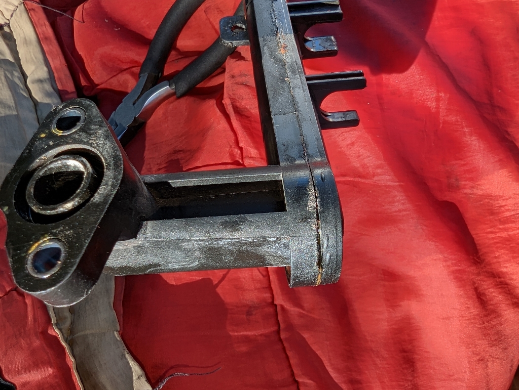

Yurp. That is the wrong coolant btw. Here is my rear xover leak

For my rig the pipe ties two coolant channels together, one on each side of the V of the block and then other engine parts connect to it for coolant.
