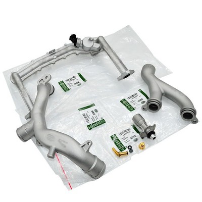

I looked on ebay and saw some that had labels that replicated the Land Rover color and layout, but you couldn't read the text. Example below.
I sent an email to one seller asking if they were genuine and received a response that these were "better" than OEM.

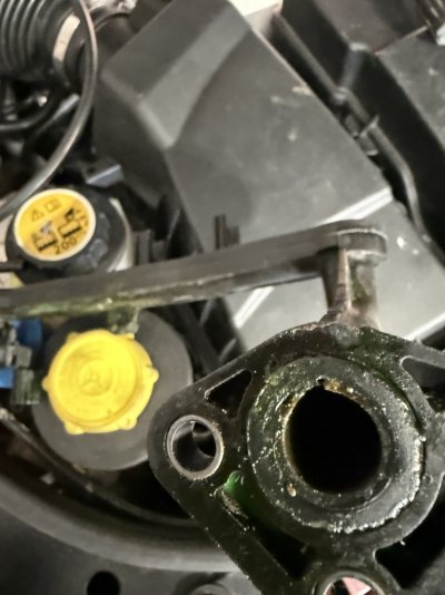

Attached is a picture of the pipe I removed.
