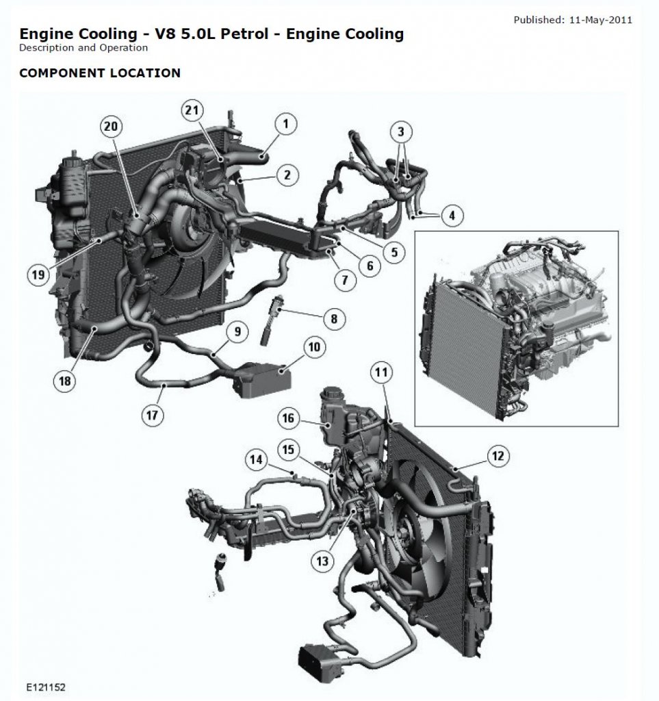

-I haven't pulled the skid plate off yet to see drip locations, but what coolant components are towards the bottom of the engine bay that I should consider?

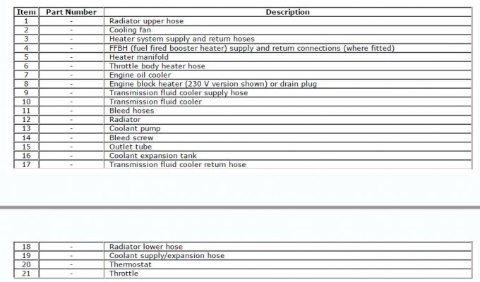

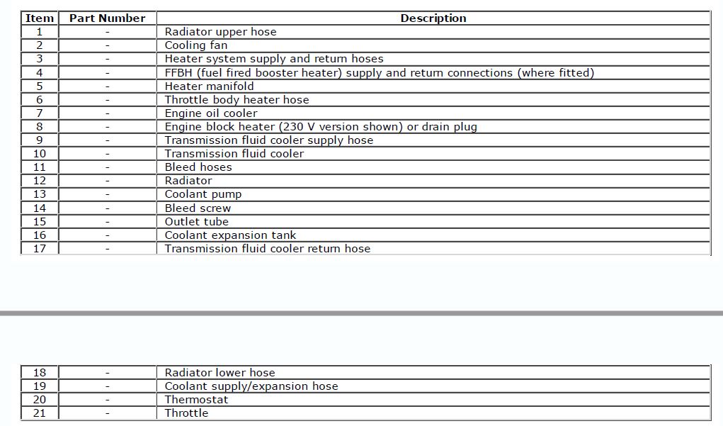

As above, OEM coolant is UV active, no need for adding anything.
Plenty of locations to examine, take your pick.
Time to get dirty!

txfromwi - Thanks for the cooling system images. Curious where you got those?
