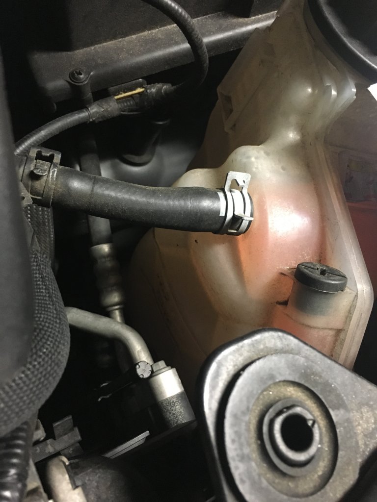

Upon installing ProSpeed light brackets on my Disco4, noticed my coolant level is low. My truck has been sitting for two days without being in use.
-No faults.
-No coolant smell.
-No signs of dry coolant around housing thermostat housing or water pump.
-No signs of cracked hoses.
Level is well below “Cold fill level” on expansion tank. Does anyone have suggestions and/or related problems? Should it be a concern? I’ve been driving on this low level for several months now as I’ve not noticed this until now.

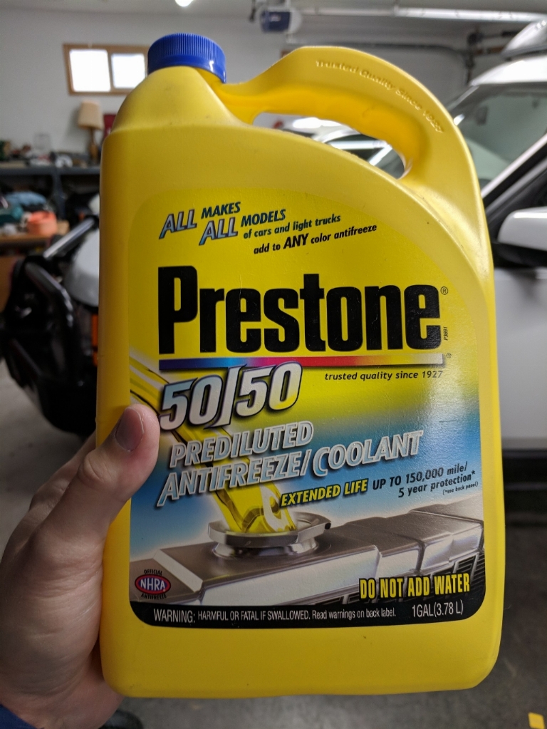

mbw
Aug 8, 2010
1,700
442
Des Moines, IA
Jack of all trades but master of none...As long as it is labelled SF (silicate free). I personally use Pentosin SF and it is not hard to find. Premixed or use distilled water, especially if you live in high mineral content areas.
I'll have to look for that. It does meet the exact LR spec, which is probably better.
I am looking at buying one of those vacuum venturi tools so I can do the vacuum fill method on coolant. Maybe ill flush it with that pentofrost sf.
Thanks
