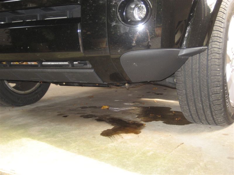

09 LR3 with 40K miles. I had to have the PVC valve replaced (car was blowing a heavy smoke trail out the back that was literally 1/2 mile long). Two weeks later, starting dripping oil and have to have the o ring replaced between the oil filter housing and block. I hope that's it for a while.

Looks like the fix for the oil leak is not a simple one as oil is still dripping - here is a pic after sitting for approx. 40 hours. Going back to the dealer again.

Turns out that concurrent with getting the original oil leak fixed, i was getting a service/oil change done too. They fixed the original leak with the porous o-ring, but did not tighten the oil filter completely and which caused the subsequent leak.
At least the dealer gave me a free oil change for all the hassle.
