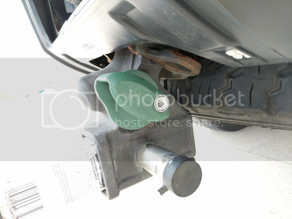

I really couldn't tell how far the pin goes in when I insert the receiver. But when I put it in, the green *** pops back clockwise pretty far and then the orange key easily turns counter clockwise and comes out.
this is the final position for the green knob. (i assume you are talking about the same receiver that I have, the 2013+ish version.

Thanks - that is exactly what I needed to see. I don't think my green knob is rotating that far forward.
