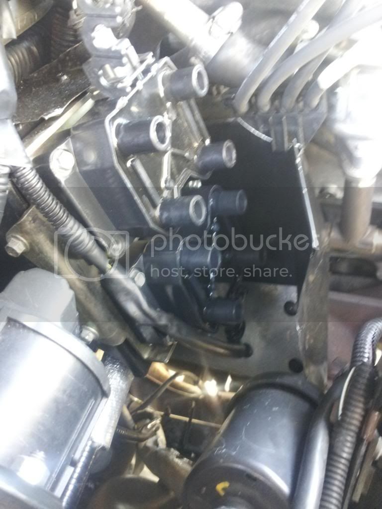

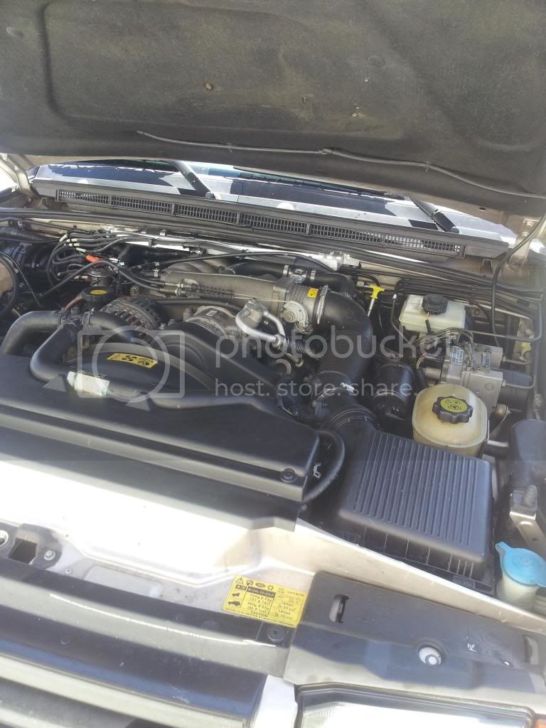

I discovered I had to change the coil packs out after some diagnostics one of my coil packs were failing. I decided to change out the coil packs myself. I discovered that the coils are on top of the bell housing between the intake and firewall a very hard access. After scratching the back of my hands up sufficiently I decided not to reinstall the coil packs in the same location. Disco Mike stated he has not see anyone relocate the coil packs successfully so I thought about it and figured it would be something I could do.
attached are some photos

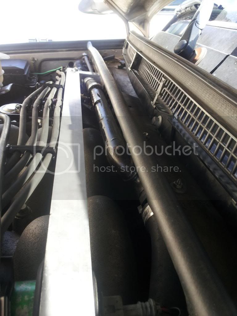

I reconfigured the secondary air pump tube making it smaller and shorter. I was careful not to restrict the air flow.
I unwound the coil pack plug wires back to the passengers side and effected some repairs to the wiring harness while making the adjustments.

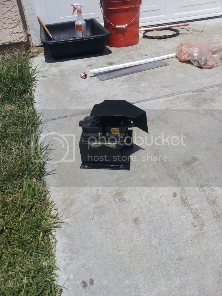

I made a stand that supported the coil pack bracket and allowed for the air pump flexible tube to pass through the stand.
I fabricated a plug wire support bracket to hold the plug wires in the correct location. It appears that the bracket is sufficient to maintain the wires and their routing. Presently I am using inadequate 7mm wires for cost savings.
I need to save up and order a new custom set of 8mm wires from Magnecor they said the price will be about $200.00. I used 7mm wires and the old plug ends to save money while I adjusted the wire lengths. I also created a heat shield to keep the manifold heat off the coils. It works very well and I can reach in and adjust the wires after driving for quite a while. Temps are considerably low in the new location.
