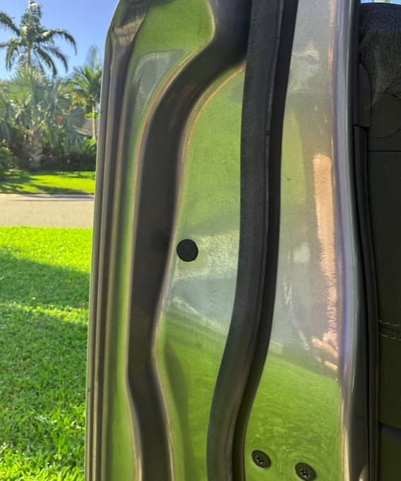

The lock cylinder does need to come out to remove the handle assembly. It is held in with a small torx behind this black gasket. You just need to loosen it enough for the lock cylinder to come out. You do not need to remove the screw completely.
