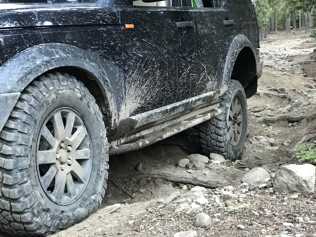

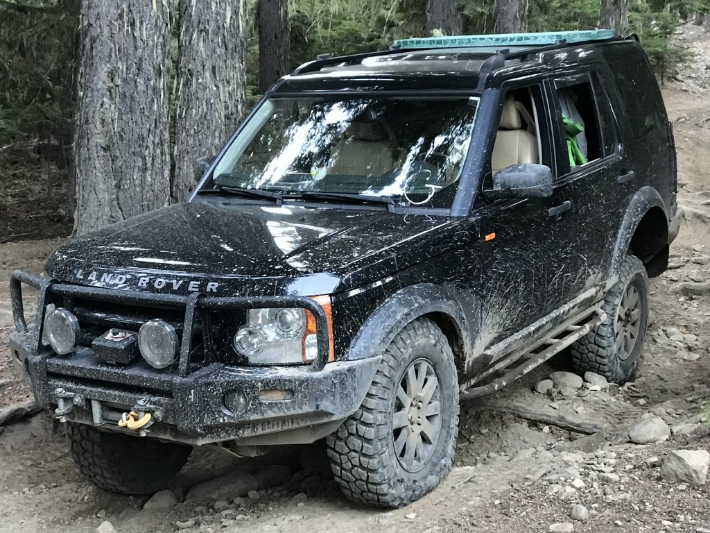

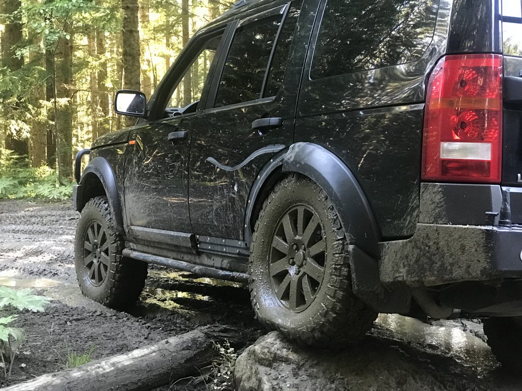

I'd bet a case of microbrew he simply doesn't want to worry/deal with the air struts. The coil deal actually reduces maximum clearances and also reduces articulations. It becomes a stiffer car-like event off road IMO. They're not terrible, but the cross linked air is engineered to seriously diagonally articulate. It's kind of awesome. Go look at my recent few posts in "show off lr3". There are a few with 34" stuffed up in.

The images you show make a great case for EAS!.
It looks like your Rover is well-equipped for the trails. I'd like to get there some day.
I see that it is 'expedition modified'. Could you list what all that entails???

tahuya didn't have anything like that as i recall but the dry photos are Naches just after historic sign and the muddy ones are after getting through a black rated Evans Creek.
The wet photo is pre-strut spacer and the dry is post spacer.
The far east end of Naches has some fairly rocky sections. The worst rocks I went through down there were at Elbe ORV park though.
