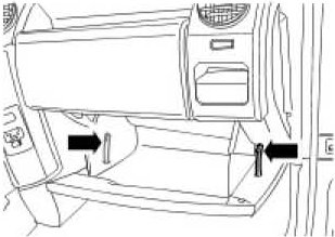

Know this has prob been answered several times on here but couldnt find it. I cant find the air filter to replace it. I know it has a pollen filter and a reg air filter but i cant find either. Thanks alot.

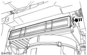

Pollen Filter
Service Repair No - 80.15.42
Removal
Open the glove compartment to the service condition. Release the glove compartment latch stops.
Remove the pollen filter housing cover.
Remove the pollen filter.
Installation
To install, reverse the removal procedure.
Clean the component mating faces.

Thanks bscmich - saved me a lot of time replacing the pollen filter. Great post!
