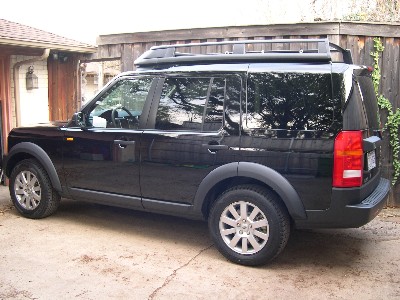

Would you be able to post any photos of your expedition rack? What do you think of it? Thanks.
K
KTMLC8
Guest
Here is a photo of the rack on the truck.
K
KTMLC8

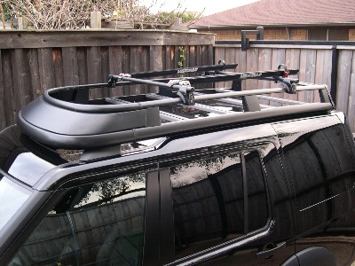

Guest
Here it is after I put my Yakima on it. I can tell you that I would not pay the retail price again after getting my hands on it. The thing is maybe worth the discounted price that one of the internet sales places is selling it at, $866 I think. Not that sturdy. Nothing like the welded tube racks. The Yakima actually stiffened it up somewhat.
O
Outrageous
Guest
Thanks for the photos. I think the rack looks very nice. It gives the vehicle even more of the "ready for anything" look. And the Yakima crossbars match the appearance. Let us know how the wind noise is after you get more at the wheel.
