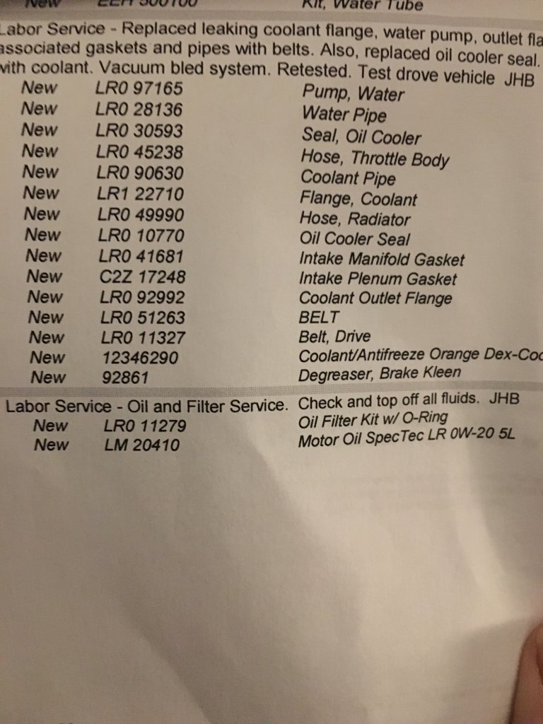

I found the receipt and parts list for the previous work on the cooling system. I’ll post the pic of it here. I very specifically remember talking about and agreeing with them replacing both crossover pipes, but only see one listed on the receipt.
If it is a rear crossover pipe issue, what would I look for that may be the ‘smoking gun’ as to blame? Outside of obvious physical damage...
A side note, the radiator was replaced at ~80k miles (currently at ~113k) This was prior to our ownership of the car, and the service report didn’t give anymore detail about the rest of the scope during that job. However, when we had the vehicle inspected pre-purchase we took it to a different dealer and had them look it over to confirm that the service records reflected good quality work. Our feedback was that it looked fantastic and *almost all parts were new. Could the rear crossover been replaced then maybe?
