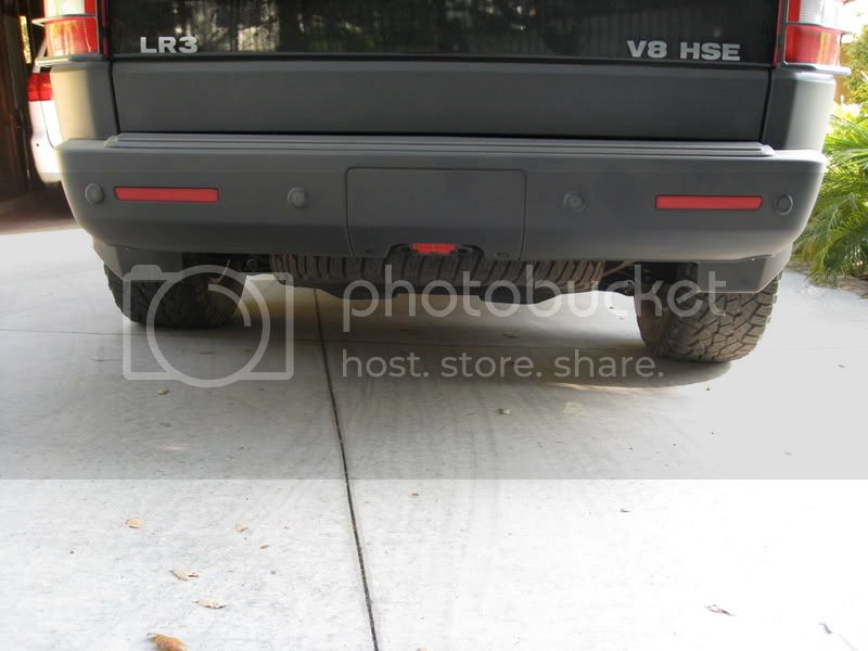

That's what I have on mine and I have one as a spare underneath. Slightly deflated to make it fit though. But I have an air compressor on board, so if I need to fill it up on the road, it's no problem. Here's a pic. It sticks out a little. As you can see from this angle, you don't need to trim the plastic cover. That's what those two bumps are sticking out a little at the front of the tire. What I'd like to try is removing the "oreo" spacers above the tire to allow it to be cranked up in there a little higher. They are at least an inch and a half thick. Anyone try that yet?
Yes, I took them out with little problem and they go back in easier then taking them out if you ever need to put a space saver back in. They are needed for the space saver.
I had to use a pipe wrench to turn the rubber stop while holding a box wrench on the bolt on the other side. They were on there very tight. But, as I said they are much easier to put back on if needed.
Works great to get the larger full spare a bit higher up.
I did also remove my plastic cover but that was more because it was hanging up on rocks on the trail and I was tearing it up anyway.
I think Nwoods has his off also when I looked under his vehicle on the trail a few weeks ago.
