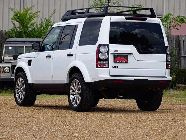

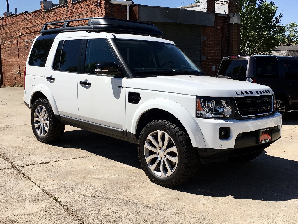

My wife and I just purchased this LR4 that will be replacing my FJ Cruiser. Really looking forward to making a road trip out west in this beast and putting it through the paces!
I really like that factory rack. If you ever decide to get a new one I'll buy that off you
