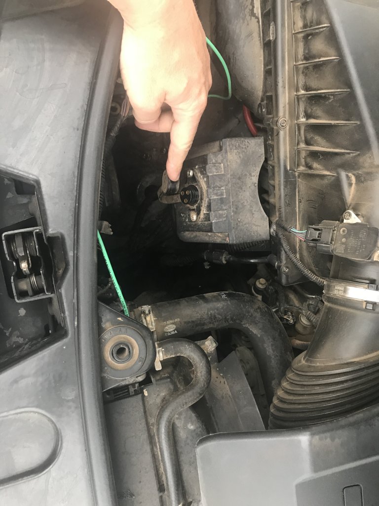

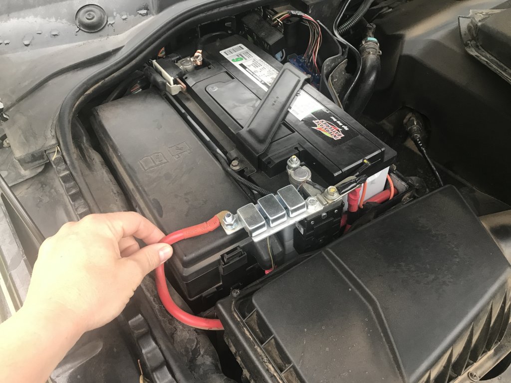

Getting a uniform spool is fine, actually have decent amount of space around drum... issue is I can’t engage the free spool lever, so takes a bit more time, but hasn’t been an issue.
I have a superwinch tiger shark 9500, so had to remove solenoid cuz no room for solenoid on top of winch...bought 2 gauge wire and made an extension kit to run solenoid inside of engine bay. Bolted on passenger wheel well

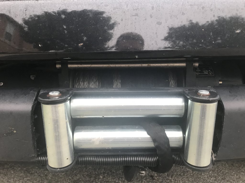

Also, I initially installed a hawse fairlead, but didn’t have the right spacers b/w discrete winch mount and my bumper, so when winching a gmc truck out of mud from an angle few months back, bumper started bending bad. So, cut more of bumper and installed rollers...
Solid setup, I can appreciate how clean it looks. Great job!
