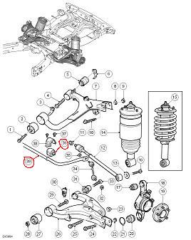

@Trynian, I'm still learning about which suspension components are which. I know what a sway-bar looks like in most vehicles, but what does the LR3's look like and where is it?
...anyone have a pic or diagram, in particular showing he bushings referenced?
Here is the rear in red is the sway bar and bushing front is similar, sorry site wont let ne do a larger file.

FIXED! I found an aerosol-propelled grease (Lithium) that was perfect because it was less viscous at first, and thickened up after it got on the surface allowing me to get it inside each bush.
