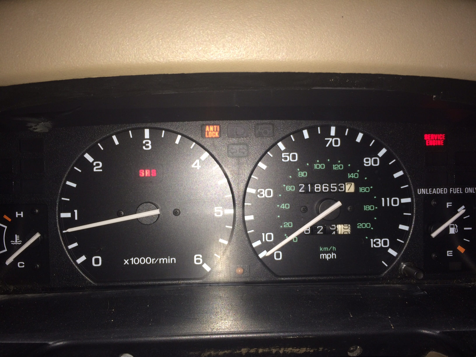

Can you take a picture of the dash with the light on?
Jan 9, 2016
7
Dash Picture
Here it is Joey. Any help would be greatly appreciated! Thanks

Sorry, I had a rough weekend with a Migraine... SRS on the Disco can be either the seat belt wiring for the drivers seat or the AIR BAG sensor. Keep in mind per the owners manual on most modern vehicles you are required to replace the air bags after 10 years (I know this is stupid, but just another way to spend money on most vehicles.)
It could also just need to be reset (requires Dealership or someone with the Land Rover Specific Computer) The SRS - Air bag computer is in the center console, so if you ever left the sunroof open in the rain it may also have a corrosion issue.
