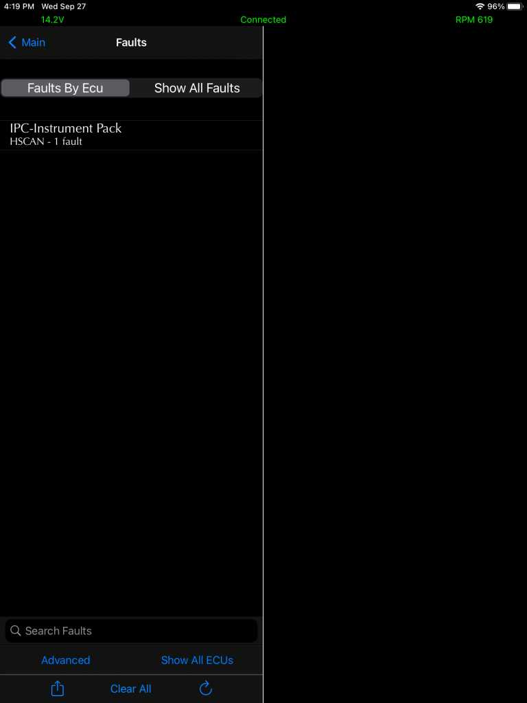

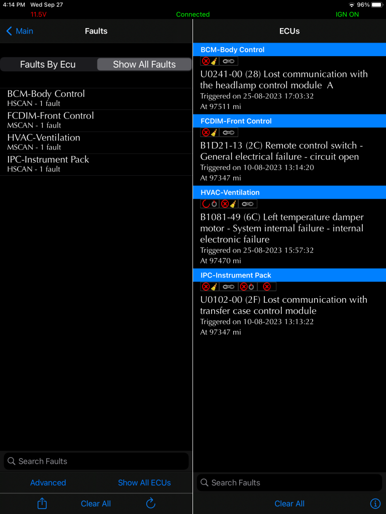

Question for the forum: was driving my 2014 LR4 HSE LUX, and my amber check engine light came on solid. Truck seemed to run just fine with no noticeable issues. Went home and plugged in my Gap ID II tool. Didn’t notice any unusual faults, at least no faults I had not seen before.
Cleared faults and now after restarting the vehicle, no more check engine light. (Might come back on after a little bit of driving. Time will tell.)
Attached are screenshots of the before faults reset, and the after faults reset. Is there anything that you see that would cause a check engine light to come on?
Should I have done any other tests with the Gap ID tool?
A thought: If you don’t reset the service required message, would that cause the check engine light to illuminate?
Gas cap tight.
Any thoughts, comments or advice appreciated!

thats a little odd... These trucks are finicky, I would wait till it comes back, check codes frequently so you can rule out the codes that aren't causing it but my bet is that the transfer case code may have set it off.
1,405
Clean your MAFs. If that doesn't work run a can of BG44K through the gas tank.
