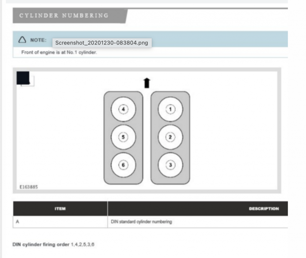

Is this accurate? Cylinder #1 is at the passenger side, at the front, and #6 is the nearest to the driver?

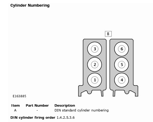

From the workshop manual I have on hand, it says "DIN standard cylinder numbering" but the diagram doesn't clearly indicate where the front is. The legend references 'A' but the diagram shows 'B', a bit dodgy. Another diagram in the manual says that bank 1 is on the right side, which would suggest the rear of the engine is where the 'B' is (assuming bank 1 would have cylinders 1-3), and that all would align with the diagram you posted.
