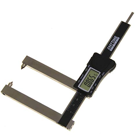

I have been using this tool for years, have saved me from buying rotors way too soon as most mechanics, even dealers I took my vehicles too, would just eyeball it. https://smile.amazon.com/gp/product/B006Y1OWKS/ref=oh_aui_search_detailpage?ie=UTF8&psc=1 . measure in a few places along the diameter and across the rotor by rotating it.
