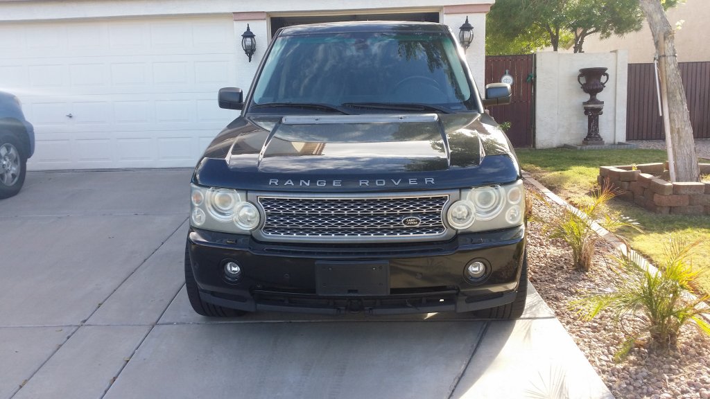

My rotors and pads on my 2007 Range Rover HSE. I plan to replace the pins as well. Do brembo rotors and ceramic pads fit a standard brake setup? I don't have brembo calipers. When stopping or backing up there is a horrendous noise as if the calipers are grabbing or grinding, not squealing. Any help is greatly appreciated.
