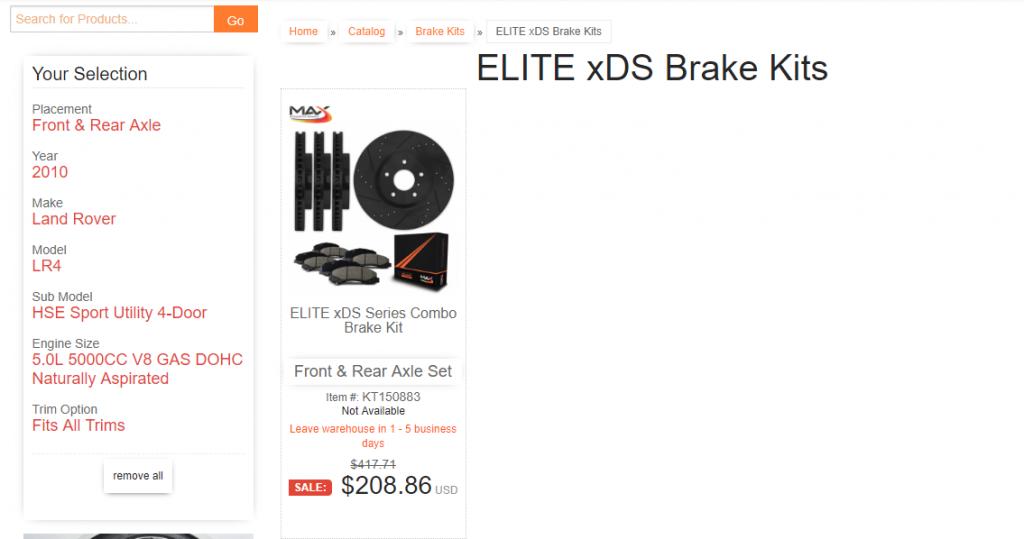

I'm lucky enough to not put that many miles on my LR4, so I just buy OEM stuff at the best price I can get.
I can understand that LR is making a huge profit on their parts and that there could be aftermarket parts for less, but when parts get too cheap, I start to worry about quality.
My 3-series brakes+rotors all around (bought in 2009) were about $400 from the cheapest place I could buy quality aftermarket parts. With a decade of inflation, etc., I could see the larger LR4 brakes being $500-600. The LR4 OEM full kit I bought from BA two years ago was ~$850.
You show me a full kit for anything under $400 or $500 and I'd start to worry.
I'm a mechanical engineer and I can tell you that if someone sells the kit for less, you get less. Lower material quality, less engineering and testing, fewer quality checks, etc.
The kit above seems to be on sale for half off, so that might be ok and a great deal if it really was $400+ originally and they are just trying to move inventory (why?). But beware of those "original MSRP" claims.
This site suggests questionable quality. http://forums.redflagdeals.com/anyone-use-maxbrakes-com-1490475/10/
Yeah- like Harbor Freight claiming "Save 90%!" when they are comparing their always-on-sale price vs a quality name-brand item. Extremely misleading.
As with most auto parts, it's generally safer to stick with well-known name brands, or buy the OE/dealer parts from an online discount dealer. I haven't had to replace brake rotors (yet) but I did install OEM Ferodo pads, which have been working nicely.
